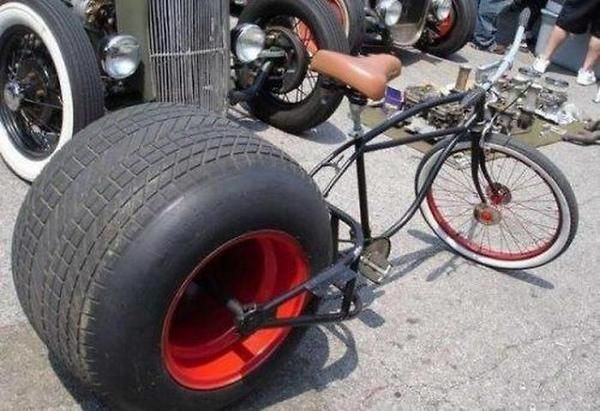

Here's some inspiration for you Velo!
Sounds like a challenge but I'm sure you'll get it done.
