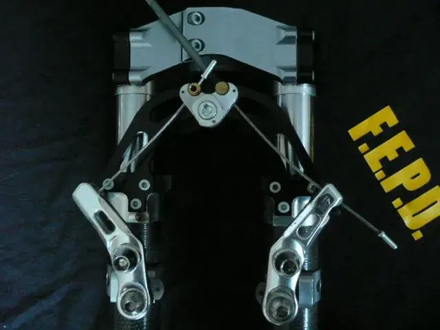

Reet... I have done a mock-up of the MXCD style brake rocker using some odd brake bits and bobs.
The pic shows the cable layout, although it would be better to have the link[short piece on left] cable the other way round with the cable barrel in the rocker and the Pace brass clamp nipple in the canti arm to avoid the cable conflict above the rocker itself.
The spring retainer[ally piece with flats] can be rotated to adjust the spring tension to suit the cantilevers as some only have a spring tensioner on one side.
An alternative is also shown in t'other picture-the front mounted 'canti bridge'
BTW the fork is for sale too :wink:

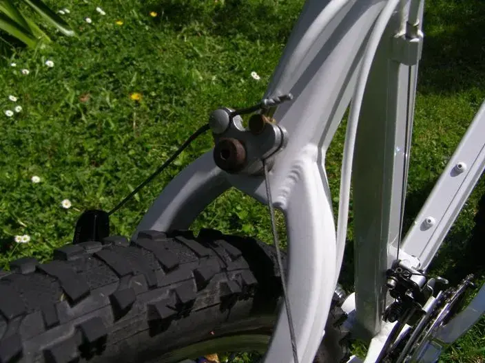

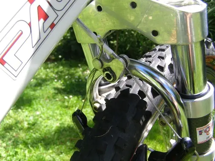

Tm sorted me out with these two rockers...work a treat :)
