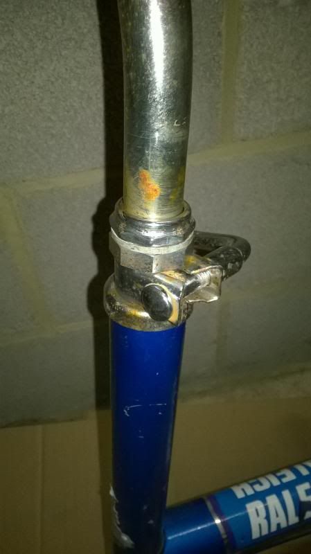

Redirect if necessary, but they're not MTB, & they're road ridden so where should I ask? Never had any interest in 'em myself, but a Raleigh RSW III came my way last week. Seeing as the DynoHub lights still work, I thought it's at least worth a tinker to get it rideable. First problem is dismantling the front end; removed h/set nuts & stem clamp, bars /stem now move freely & pull out so far from steerer but then stop dead. Is there something else I should have removed? Also I would think once the nuts & clamp are off, the steerer should slide through the lower bearing but that seems solid (through corrosion or dry grease ?)At least if I can get the stem out, I can try tapping the fork through. Any ideas?

Did you just loosen the stem expander-bolt, or take it right out? All I can think is that the expander-nut is either stuck in the steerer, or fouling on something that prevents it being withdrawn, but I'm not familiar with this particular model of bike (on a mechanical level). Have you got a picture of how far you got?

Sorry I should have described it in more detail! There's no expander on this, the one piece bar/stem is secured by tightening a clamp around the steerer (above the nylon sleeve which serves as top bearing, but below the lock nuts)! I guess I'm going to have to dismantle the front mudguard assembly (like Raleigh Wisp moped)so I can look up inside. Then I can belt it!

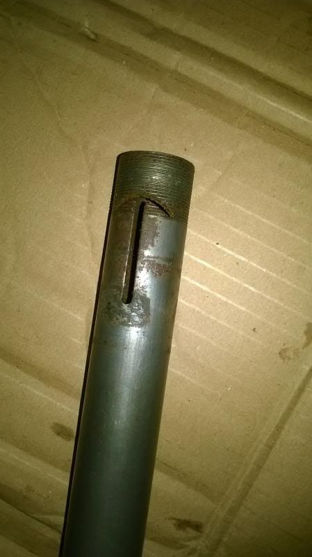

First mystery solved: This pic shows the safety wire, & the end of stem where it's secured by a roll pin (does this look factory, or the work of an anxious parent with basic skills?):

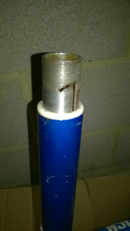

Once that was out the way, I could get a look at everything & realised the stiction was caused by corrosion on steerer where it passes through the nylon bush, also in this pic notice the cut out which allows clamping around the stem:
A little clean with fine wet & dry, & apply some silicon pipe lube, it spins beautifully. That bush is about 1" long & easy to remove:

The bottom head bearing is a normal loose ball type, & was really clean so I'm hoping no serious internal corrosion elsewhere! Might be able to ride it round the yard soon, then decide if it's worth persevering with! (I made sure to hook up the safety wire when I reassembled it, superstitious or something?)

The wire holding in the bars was a factory fit, stopped people raising them too high :)
Hopeless headset arrangement, damn Raleigh bean counters.
