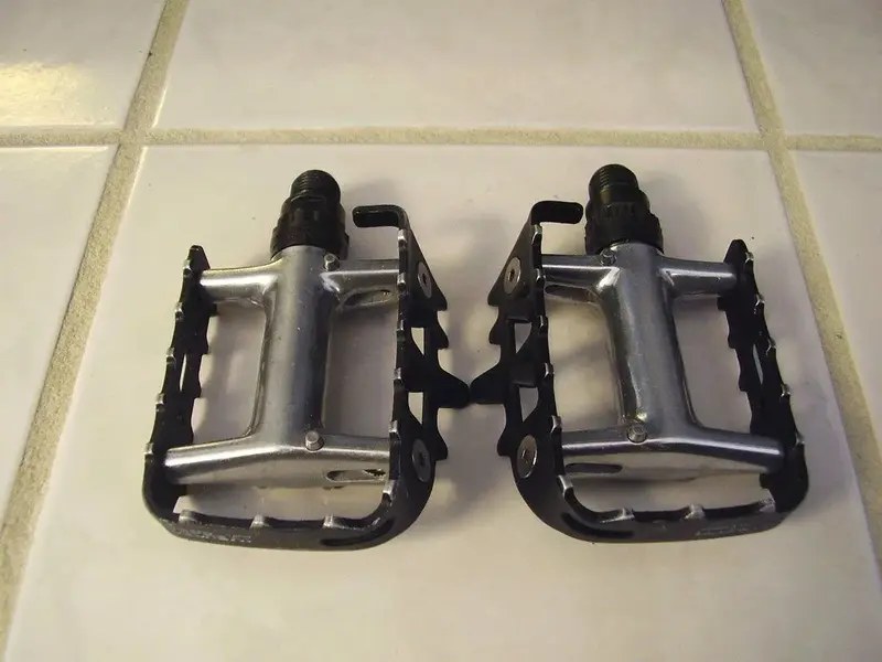

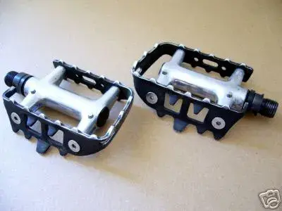

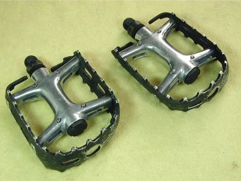

I make that four:
M730
M731
M735 (standard axle)
M735(?) (cartridge axle)
I think the last ones are relatively scarce. I couldn't come up with a picture - I'll post one if a pair shows up.
So here's the pictorial summary:
