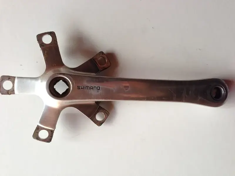

okay so i have a quick/ probably quite dumb question...
are m730 cranks bare aluminium so i can just polish them to a shine, or do they have an anodised finish? i borrowed this picture from the forum which i think illustrates what I'm asking quite well. it looks like the wear you see on these arms is through an anodised surface so polishing wouldn't tidy these up unless you had them refinished
can anyone shed light on this please? cheers

You can sand them with fine wet and dry to remove the anodizing and then polish them to a mirror shine.

The M730 is anodised, In fact BITD I think it was the only Shimano crank that was, Even dropping down one group to the Deore II/ Deore DX MT62 saw a barrel finish which lost it's lustre quicker but was also much easier to polish.

It really depends on what you have at your disposal, by hand it is going to take time, possibly a good afternoon with various grit. Even with machinery its not the quickest process as you have to ensure you remove the anodising in a uniform fashion, otherwise when you get to the final polish you will notice hazing and have to start all over.
I've done many cranks from many different manufacturers so it is definately possible.
Drop me a pm if you want any advice on polishing mate and I may be able to offer other solutions if you have your heart set on the M730's.

It would be the MT62 as i think all the M7XX will be anodised. The MT62 looks very similar to the M730 just a different finish, printed logo and a different forging process, IIRC there were also two variants of the MT62 with one looking very slightly sleeker than the other but not overly noticeable.

As KF says - it's entirely doable on the M730 cranks. As long as the threads and tapers are OK then any set of M730 cranks are worth doing - they are extremely high quality forgings and still well sought after even outside retro MTB circles (touring for example).
If there are no deep gouges then you can do them in two hours of 120dry/240dry/320dry/320wet/600wet. After that it's a 3 stage machine polish with grey/green/blue compound. Twenty minutes.
If there are deep gouges then the extra time on the 120 and 240 stage depends on how bad they are. That's how I do it anyway.
