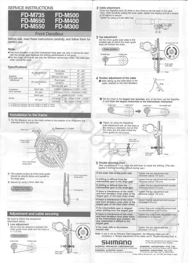

Just got a hold of this. FD-M735 M650 M550 M500 M400 M300: 1990/1991, covers all the common FD retro models, and nowhere to be found on shimano's site. Has M071/M091/M092 levers in it, and interestingly no tension adjust on the mech spring, so I guess that was '91 on right?
egg shaped? what adjuster are we looking at ?
For reference the 1991 catalogue was August 1990.
and as you said though I'm not sure what you're referring too, there was not M092 (ServoWave) version in 1990. I think I've missed something :-)
Ok.. 1991.. But it doesn't figure it hasn't got the tension adjust in. That's confusing me. The egg vs. parallel is these adjusters. It looks like that I thought was 1990 only, applies to 1991 too. I was sure I'd seen the egg ones before that though.
