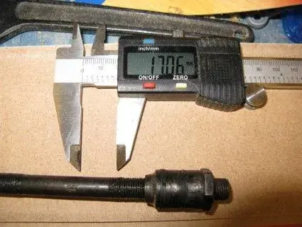

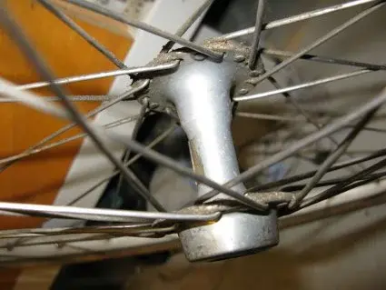

Thanks for the quick reply. Yes its an MTB hub images attached caliper shows o.d. of cone @ 17mm

Quite a few pre-parallax hubs are similar, until you hit XT sort of level, then the grease guards get fancy.
Your hub looks a lot like LX550. exage. Whilst rebooting a marin eldridge this year i encountered a pretty duff freehub and grumbling bearings so, i took an educated guess and purchased this.......
http://www.chainreactioncycles.com/shim ... -prod87011
So i gained a spanking new freehub body, cones, bearings and just had to mess and swap round the grease guards until it went together correctly, a new mixed with old kind of job at a price cheaper than the freehub on it's own. The axle was kept as per original one, being longer than the RSX.
The drawback is that you intend to go 9sp at the rear. Again many freehubs will work with your existing shell. LX570 will, that i do know but again, the seals/guards may have to be a botch of new and old to get it all happy.
Whilst you are at it, check the main shell bearing surfaces for pitting and general wear, if in poor nick it may be worth looking for a good condition like-for-like and swap it out to save you some spannering. Although a wheel re-lace is on the cards then.
All the best.
Why not buy a deroe freehub and a matching deore axle and cone kit from a modern hub and use the DS cone and axle only. This way no seal issues.
