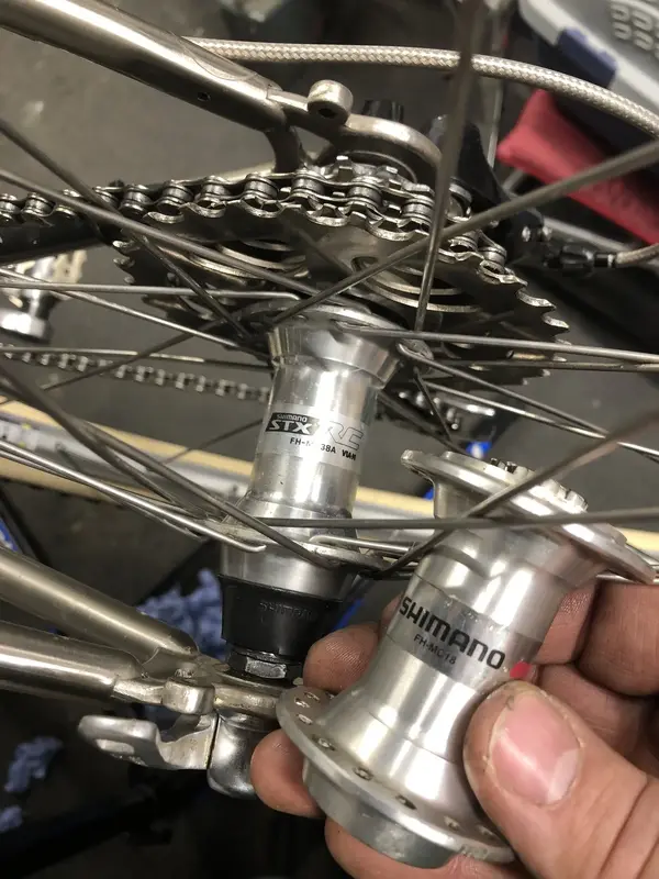

Did this last week on my ‘97 Cape Wrath. The freehub on its ‘97 STX parallax hub was knackered so I swapped it for one from a 2000 Parallax hub that cost £4 from a bike jumble, perfect fit. 8269DDA7-A107-4883-82A0-C334D72025AC.webp
Will have a look tomorrow,think I got one of those for a mate before but not sure if I have one currently.Pretty cheap,around the £20 mark and not uncommon.Which all helps!
