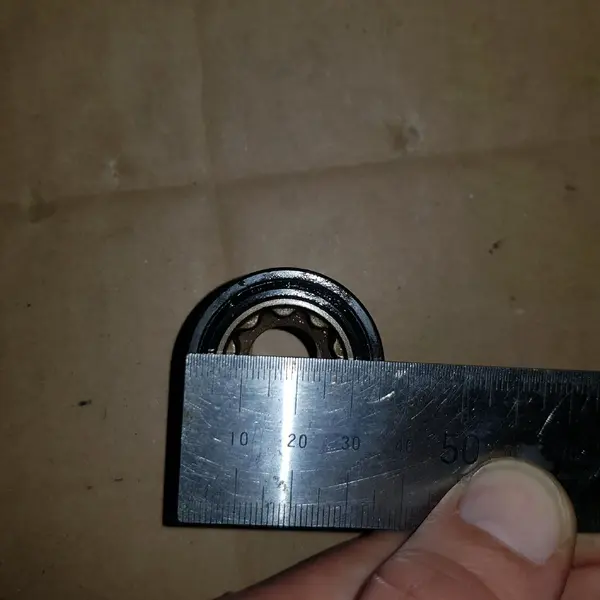

Thank you Paul. I'll take the freehub off and look for numbers. I was away from the workshop and didn't have a 10mm allen key handy. Im guessing the part number will be stamped on the side that faces the wheel hub, as I saw no numbers when it was attached.

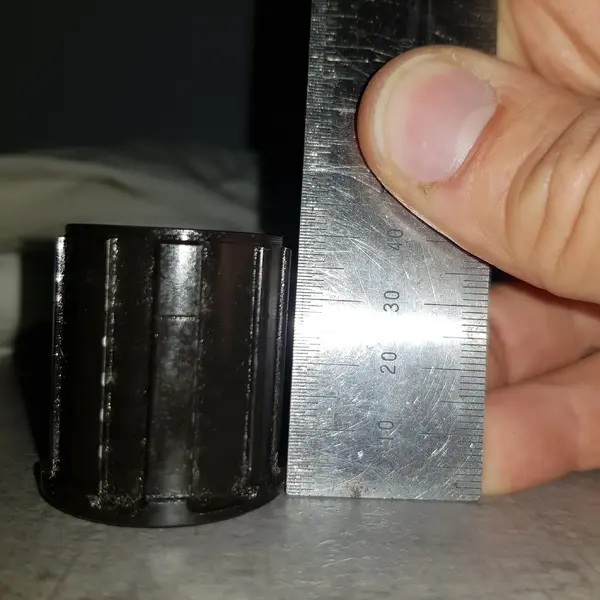

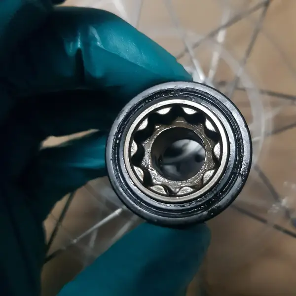

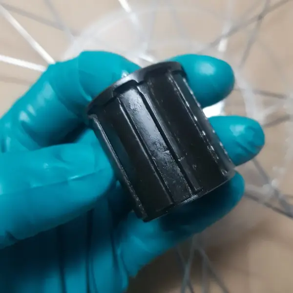

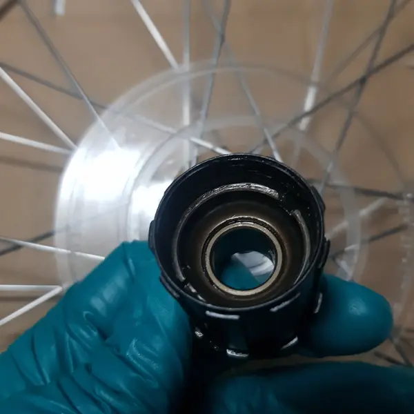

Thanks captaincowelly. I'll search for him. Attached are some pics. The dust cap is missing from the last pic. I couldn't see any part numbers🤦‍♂️

No problem.Do you have any pics of the hub?Should be Shimano FH-M then 3 digits (or similar) written on it.If the front hub matches,will be on there too.
