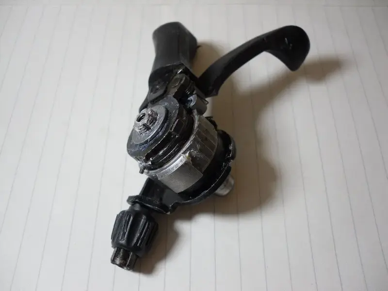

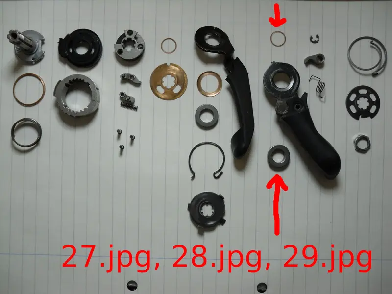

hookooekoo Senior Retro Guru Mar 23, 2021 #31 Add the push trigger to the shifter assembly. Attachments 28.webp 35.3 KB · Views: 44

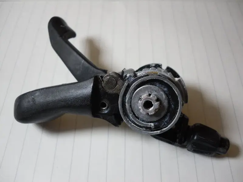

hookooekoo Senior Retro Guru Mar 23, 2021 #32 Add the steel spacer washer to the shifter spindle. Attachments 29.webp 34.9 KB · Views: 42

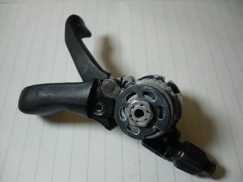

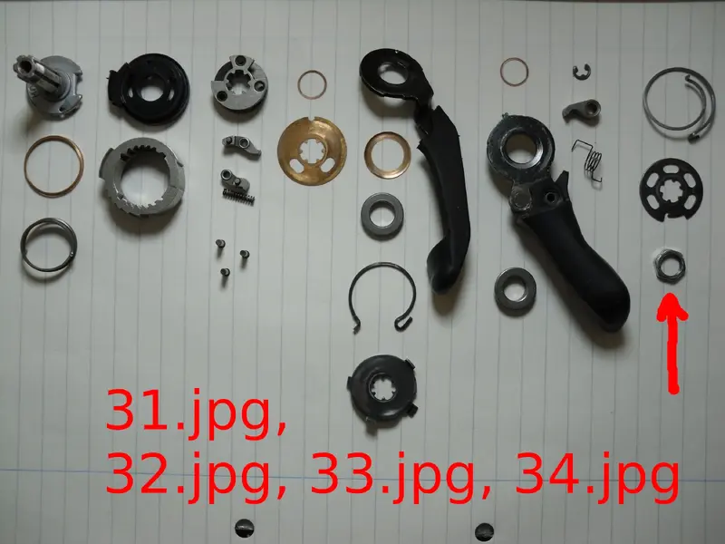

hookooekoo Senior Retro Guru Mar 23, 2021 #34 Place the return spring for the push trigger on the shifter assembly. Attachments 31.webp 43.9 KB · Views: 44

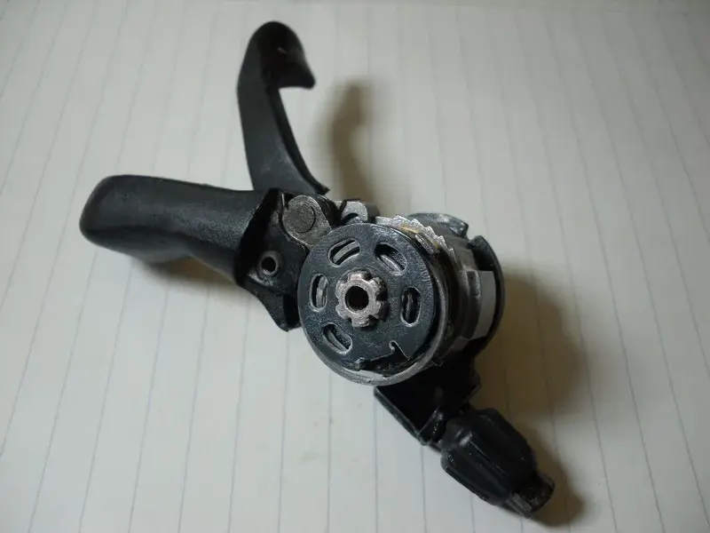

hookooekoo Senior Retro Guru Mar 23, 2021 #35 Add the special steel washer to the shifter spindle. Attachments 32.webp 37.4 KB · Views: 41
hookooekoo Senior Retro Guru Mar 23, 2021 #36 Secure the shifter assembly with the nut. Attachments 33.webp 42.7 KB · Views: 38
hookooekoo Senior Retro Guru Mar 23, 2021 #37 Tension the return spring for the push trigger by pushing its tang anti-clockwise around the shifter spindle, until the spring tang locates in the notch in the special steel washer. Attachments 34.webp 41.1 KB · Views: 40
