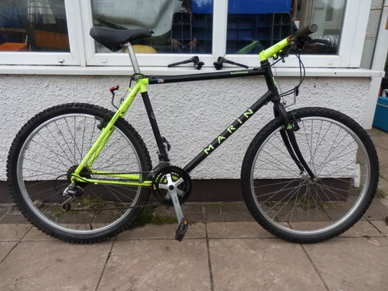

Hello,
i have a 1992 Marin Muirwoods which has the orignal 200GS running gear :lol:
the problem is the gear shifters seem to not work well at all. The rear gear shifter works ok going from 1st to 7th but doesn't work going back up It will sometimes work rarely lol.
The front shifter will move the derailleur but it will not stay in any position just moves back down.
Anybody know if this can be fixed? don't really want to change the shifters really.
thanks
