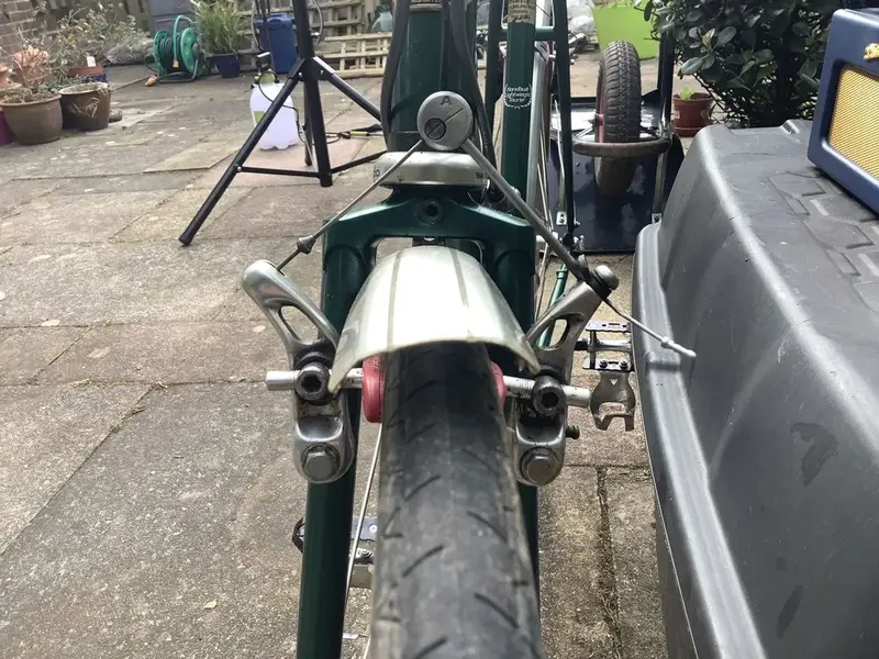

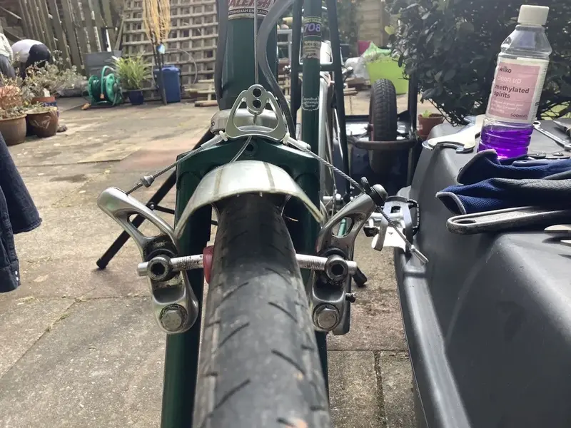

Had a play. As originally set up the rear was better. Less of an on/off feel at the lever.
Rear:
So decided to tweak setup on the front.
Before:
After:
There’s an improvement in feel - it’s now closer to the rear. And messing about in the front garden I’m able to lock up the front wheel.
But on a test ride they’re still a bit meh. I’m wondering about just changing them out completely for something wider profile... maybe you guys can see room for improvement in my setup?

There's a good section on sheldon about canti setup, and I think LGF knows his cantis too. if the arms are more "vertical" and straddle shorter and more horizontal (as in the first picture of the front above) then "power" will be greater but modulation will be worse. Wider arms and longer straddle will mean better modulation, but you need to get the correct setup so that you have maximum angles and greatest power before the levers hit the bars (sheldon explains this well). The rear might have better modulation due to the longer cable, especially if it's a full outer cable all the way from lever to canti, unless you've installed really good compressionless outers then there is always a bit of give
They both don't seem set-up right according to the Shimano M-System instructions.
When the pads hit the rim, the cable and engraved line on the cable straddle join should line up perfectly.
The A straddle length is the shortest which sounds about right.
Unless the distance between the bosses is very short, or your rims very narrow I can't see them not working as they should.

I'm not sure about the power vs modulation thing thing you're describing but maybe I misunderstand you - I'm not sure about modulation, but I think feel and power are down to the level of mechanical advantage in the system. More mechanical advantage = a spongier feel, but more actual power. The downside as you point out is that too much mechanical advantage means you might run out of brake lever travel. It's a bit like having a lower gear on the brakes. Also it gets complicated because mechanical advantage changes as the brakes move...
In the switch from the before to the after pic I was attempting to increase the mechanical advantage of the system by lowering the straddle wire and bringing the brake arms out wider. It has worked to some extent but I'm not 100% happy.
I agree with you, but IMO the "M-System" approach isn't going to work because it's a not an MTB, so the distance between the bosses IS pretty short, the rims ARE fairly narrow, and probably more importantly the brake levers are not as-per Shimano's specs.
Lovely bike in the link.
https://forum.cyclinguk.org/viewtopic.php?f=5&t=73781
It's a tricky one... my gut feeling is that while wide profile cantis will work with road levers without too much fiddling about, getting low profile ones to work really well is a bit of a PITA at best. Historically canti bosses were fitted to touring bikes in the days of Mafacs etc and the tradition continues... It depends what your expectations are I suppose but you ought to get much better stopping power than you do from standard road calipers otherwise what's the point?
I wouldn't of widened the canti's, just lower the straddle wire, nothing more apart from correct alignment of the pads.
Years ago, and it may still be on the web, Keith Bontrager did an excellent artical on canti setup.
One of the problems that's hard to overcome is that low-profile cantis need a bit more cable pull than wide cantis. Shiamno actually changed their MTB levers to match this extra pull. With conventional road levers you encounter problems with setting the whole lot up again as pads wear.
Dia-Compe did a special lever which pulls a bit extra, the 287 (not the 287V which is for V-brakes).
I've a pair you are welcome to for £10 posted. Otherwise, it's easier to get some wide profile cantis.
