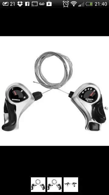

Found some nice thumb shifters on the bay for it,tournay? Not sure how good they are?

Might give it a bash,take it the LBS could fix it up if I get stuck? Theres nothing I can muck up too badly?
