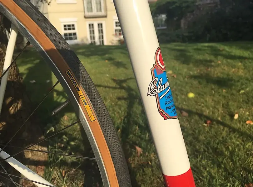

Just out of interest, my first pair of decent wheels had 27" Michelin Elans on Weinmann Alesa rims, which is like the other way around- a narrow tyre on a rim whose width was designed to complement the ubiquitous 27x1 1/4" tyres of the Seventies and before.
Mmmmmm Michelin Elans..... I’ve got some on my Super Coureur.., on early Belgian Weinmans.... they roll soooo well. ;)
And yes, they are 25mm designed to run on 1-1/4” rims (see label)
