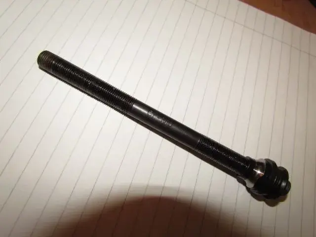

Will upload the pics of the axle a bit later.
However, it is a fairly standard looking axle, really doesn't look any different from ones I've had on much lower end hubs.
It is approx. 145mm long and 10mm in dia, with threading approx. 52mm long at end end with an unthreaded section in the middle of approx 40mm. It is stamped "Cr-Mo" in the untreaded section and of course hollow for the Q/R.
Pics of the axle as requested.

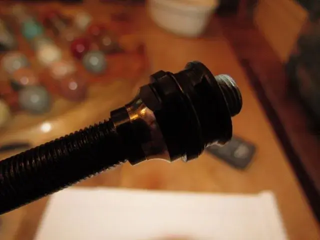

Cone and lock ring are on the drive side end of the axle.

That cone looks like there is some pitting starting. If the race in the freehub is similar then no worries, if it in better condition then consider getting a new cone (you can still get them).
And off course some new Grade 25 ball baring, stainless steel if you want the same spec as what was in there, that is if they are looking bad.
Luckily all the bearing surfaces are fine, just a bad picture - struggled to get a decent one taken.
Will get the parts washer out and give both the hubs a real good clean and re-grease and they'll be fit to go!
