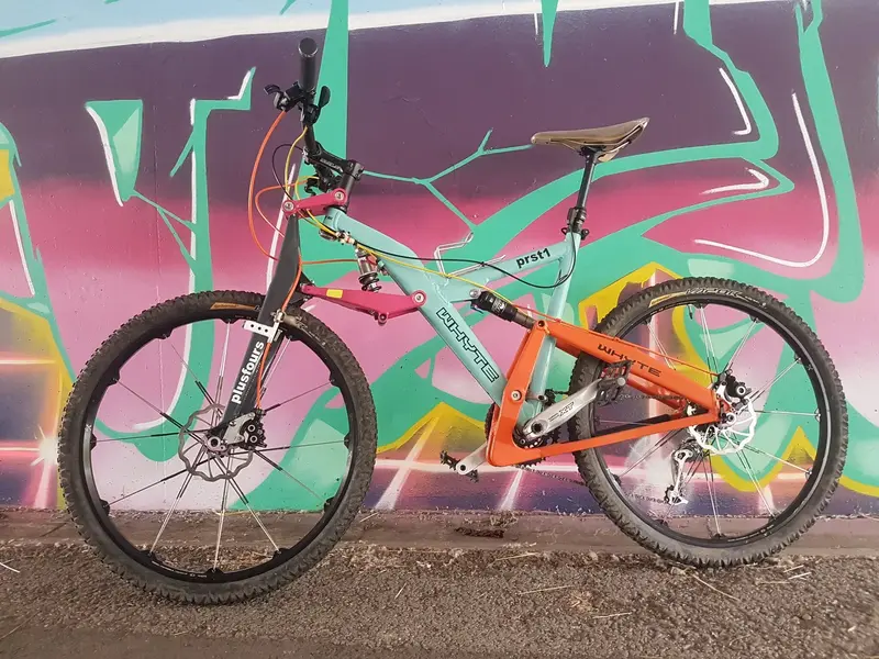

My Preston that i recently coated - I did ask for this back after blasting so i could mask it of.
