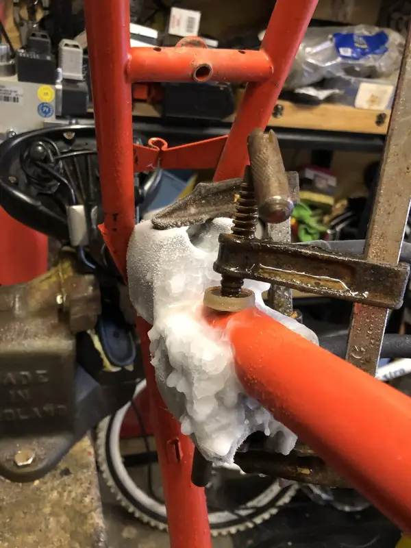

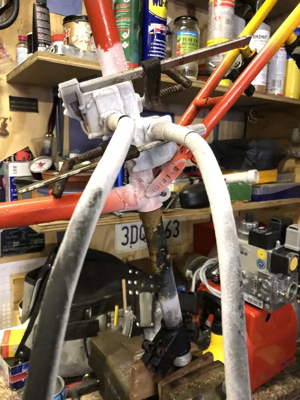

Thought I’d post this up as I’ve never seen or heard of this for removing a stuck seatpost. Sheldon Brown says a stuck alloy post in a steel frame needs to be cooled not heated to remove. So, I thought I’d try our firms pipe freezer machine which we use for plumbing jobs..
I was also blasting the exposed areas of frame with an aerosol pipe freezer to chill that down... Hey presto, success!!
