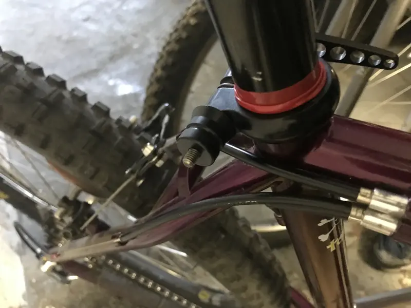

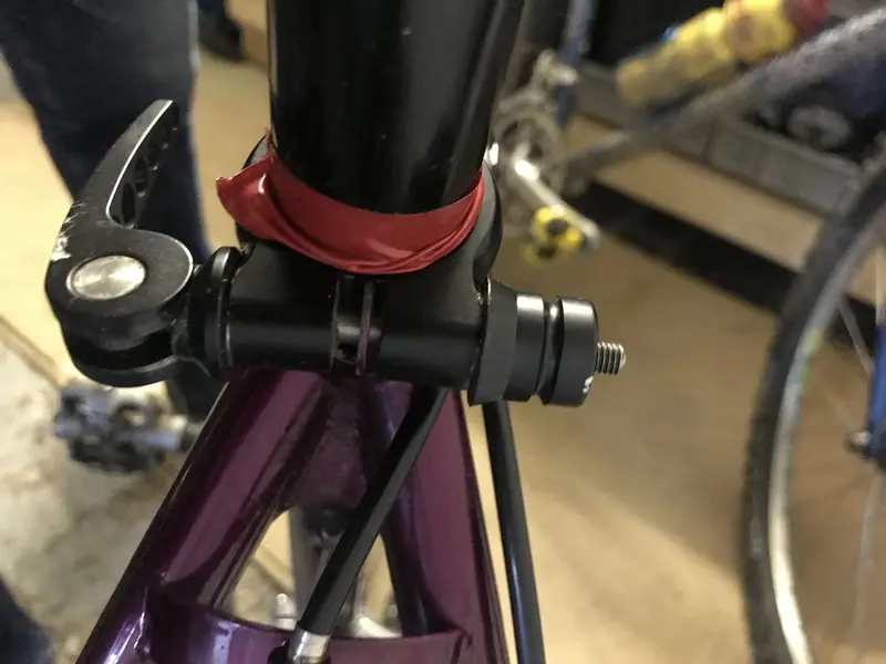

Post a photo of the clamp bolt area.

Will upload a picture tonight.

Hmm, external cam QRs really don't allow you to apply that much force. I would try a bolt across that collar first to see - once the waggle test is done.
Collar shape looks ok although the 5mm bolt won't provide much clamping force.
Cam shape affects leverage to tension ratio. Some cams can provide more tension than an Allen head bolt, many do not, especially those crappy ones that sit in a plastic bucket washer.
