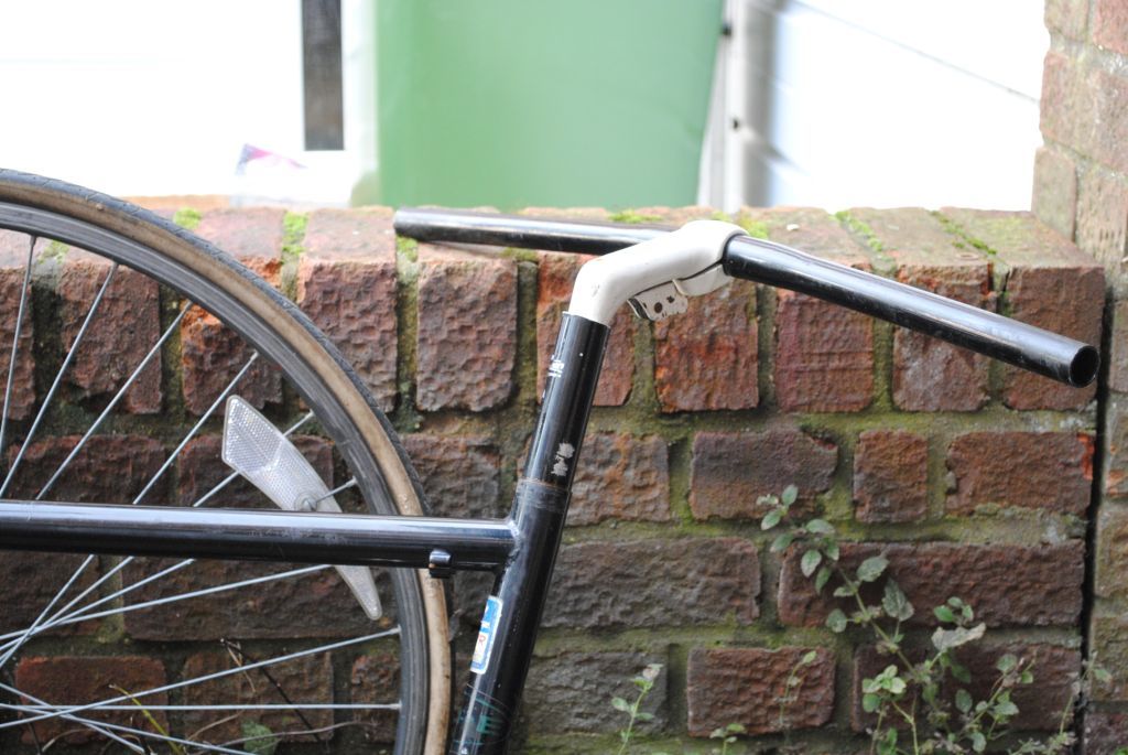

I need some advice. I have a steel frame and the alloy seat post is stuck in place. 99% sure its got a shim fitted. What are my options to remove it? Trying first of all soaking it in oil and seeing if that works.

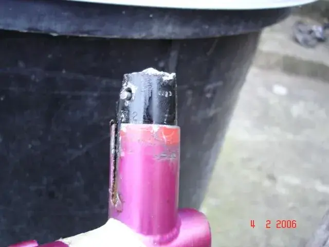

if you are willing to sacrifice the post (I had on snap in the frame). then it is possible to drill a hole i nthe post and the use a steel rod or drift to lever agaisnt the frame to push the post out. (hoe I got mine out).
