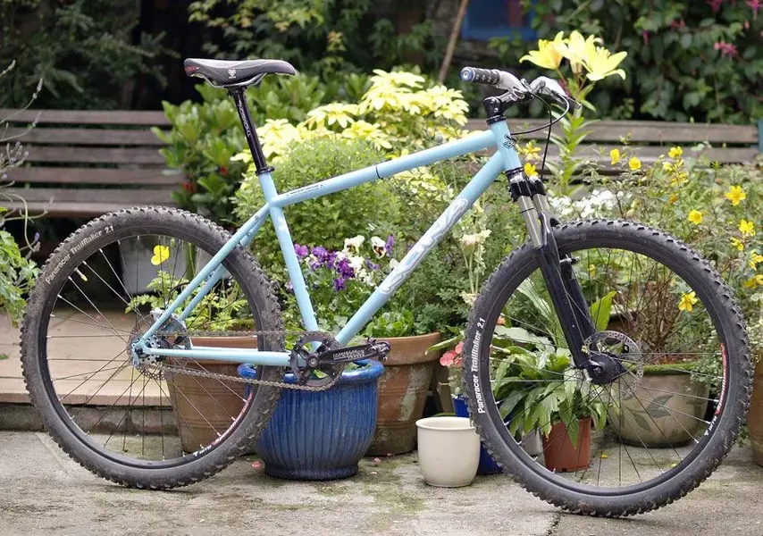

I also ride a '94 (I think?) Explosif singlespeed and have run it 32:18 for the last month, however I fitted a 19T sprocket today which (praise the Lord !!) gives perfect chain tension with NO tensioner. Ideal :!: - so that's what I'll be running on that bike from now on.

Apologies to those who have seen it before - I lurve this bike so much :oops: Here it is 32:19 and no tensioner. Yes !!!

Andy - that is a sick looking bike!
