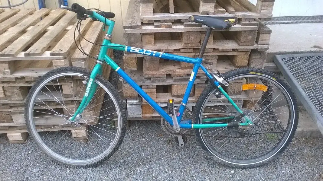

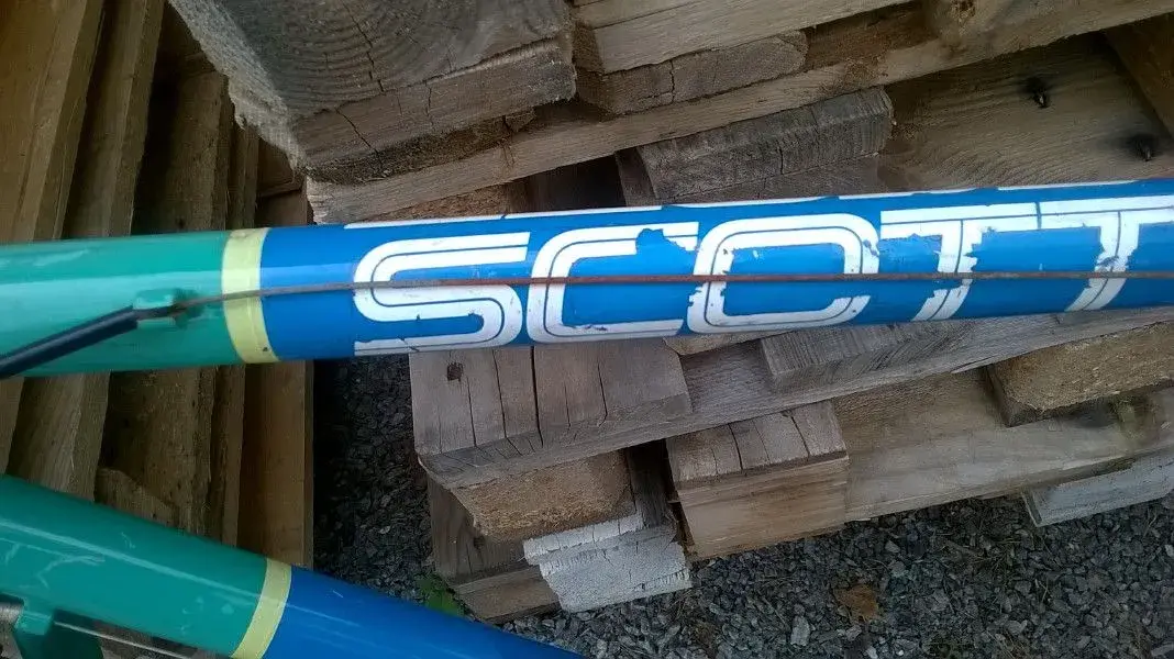

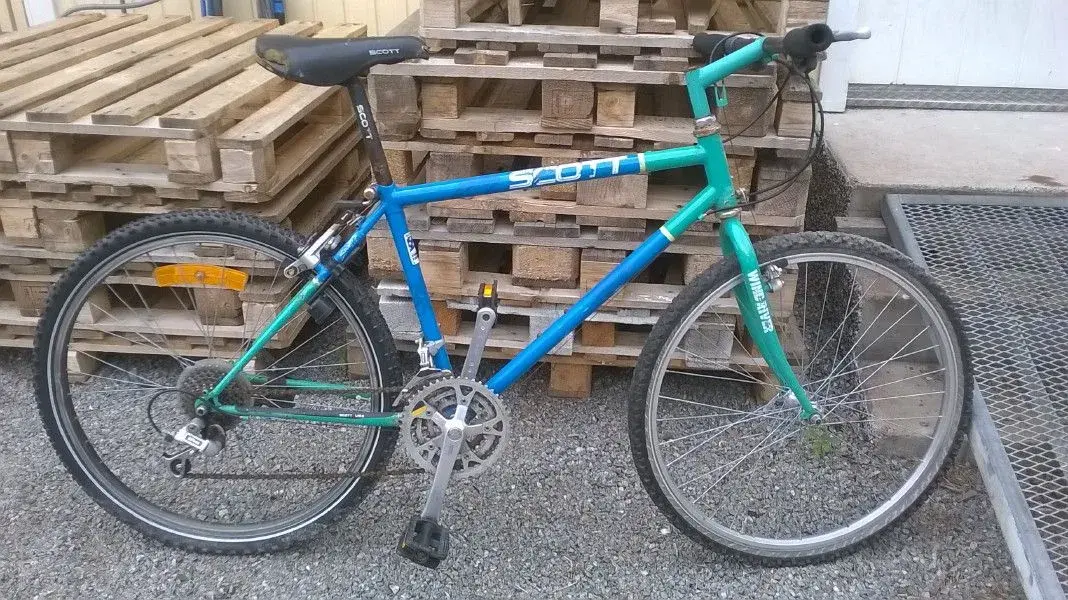

So I found a Scott Windriver to add to my small collection of old MTB´s.

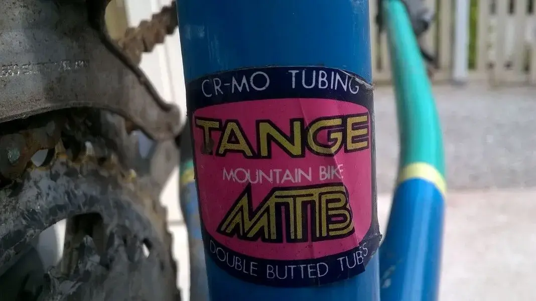

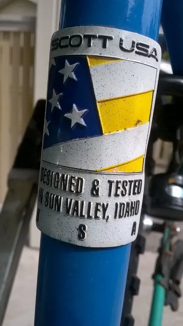

Frame number is F9107908
I belive its a 1990 or 1991 modell ( more 1991 based on the frame number) as to a 1990 cataloge I did find on the net.
http://www.mtb-kataloge.de/Bikekataloge ... tt1990.pdf
According the the online cataloge size is Small, just about fits me, even a Medium would be best size for me.
Color is same but spec is some difference, mainly crank that is a Deore, not Deore DX and rims are not same (are Araya), and the one on bike are same modell/make but diffrent color for some reason, changed? Also I do wounder if rear brake is stock?

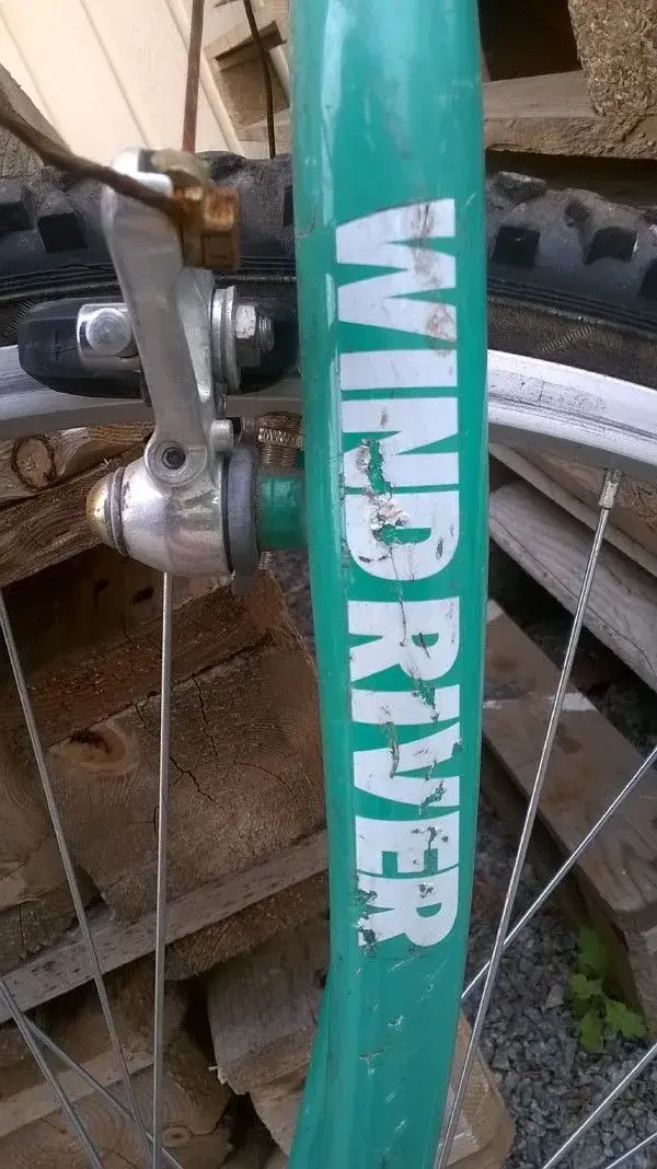

Front is a normal canti

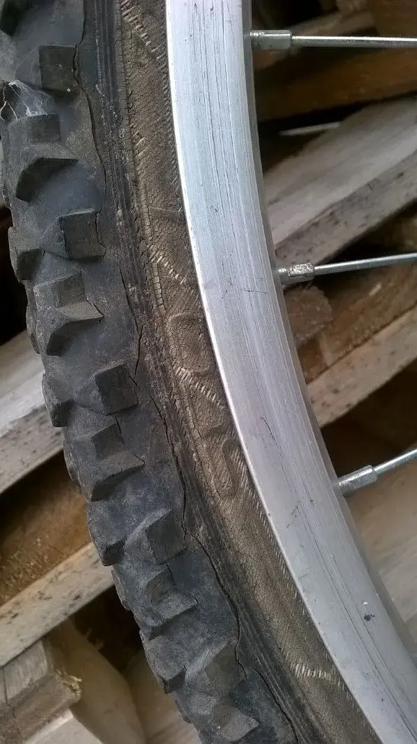

Condission is quit good, even frame has some marks. Components seem on OK shape and triggers work as should. Needs normal stuff as a bike standing for while, needs new shift and brake cables, inner as outer, brake pads, a front tire, rear seem new!, seat has seen its best and rear wheel has 2 spokes broken/missing. An new chaing would also be good. Former owner has lost the key so the aftermarket look has to be cut off. Seatpost is NOT stuck! :D So a light restauration needed. I think the price I did pay for it was not bad, € 20, that`s about £ 14 nowdays

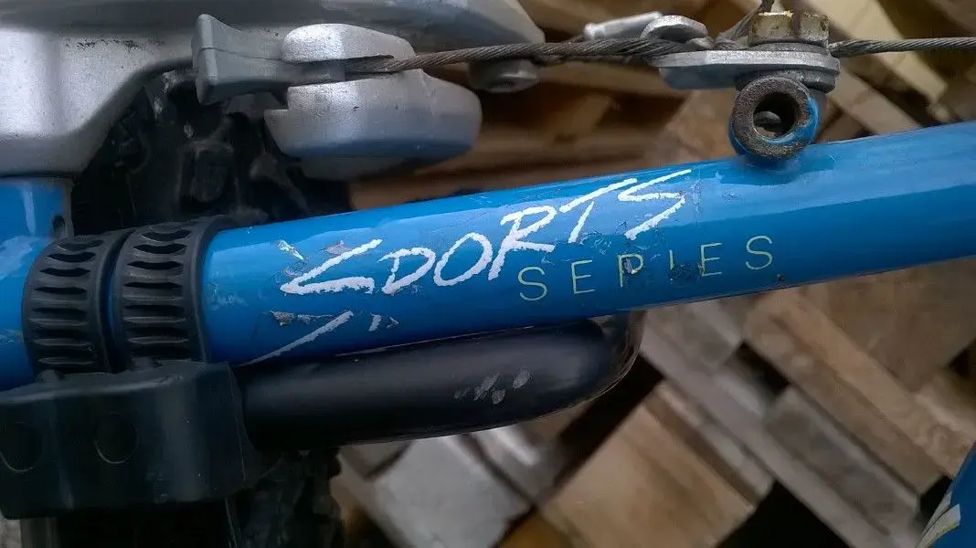

Some more pics

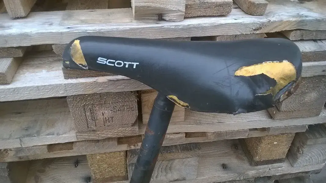

Seat is stock but needs to be replaced also
Front tire has old related cracks, and scott brand

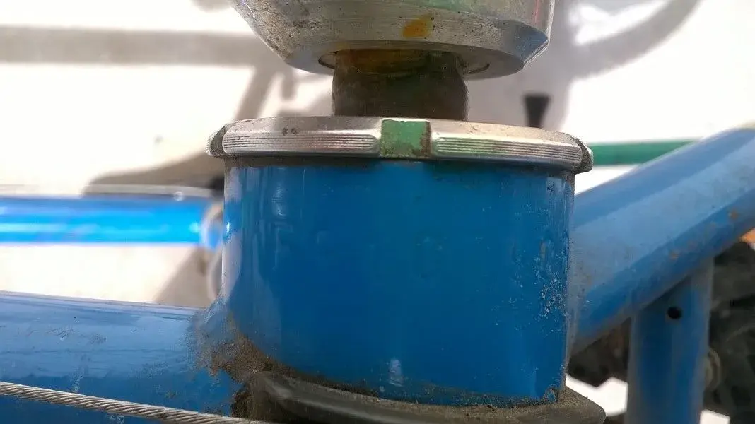

Frame number

Hi,
Your bike must be 1990 or probably earlier. My Windriver is from 1991 (similar to this viewtopic.php?t=176546) and it already has cantilevers front and rear, so the fact yours has a rear U-brake means it's older. Also, your front cantilevers are "normal" while in mine are already the "low profile" type. And finally, your chainrings are Biopace, which disappeared in 1991 as far as I remember.
Much more I can't say, but I like a lot the color combination on your bike! Be careful taking care of the paint, it is not the strongest point on old Scotts...

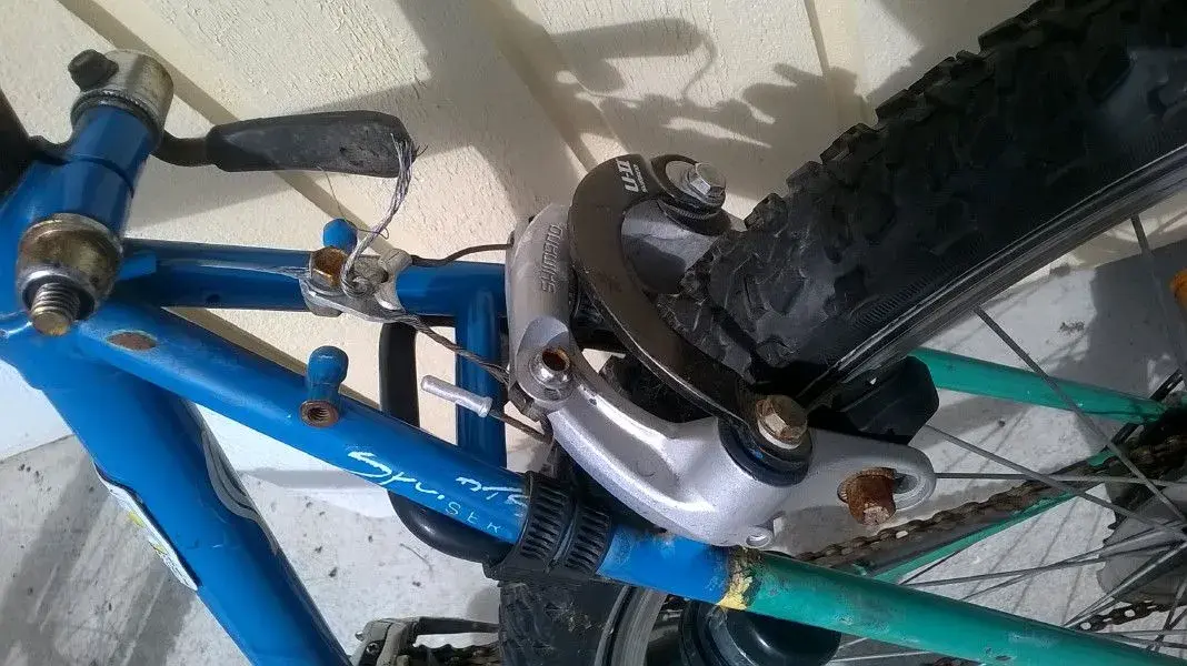

Back to the U brake, what kind of brake pads does it take?
Re: A bike added to the collection, Scott Windriver 1990?

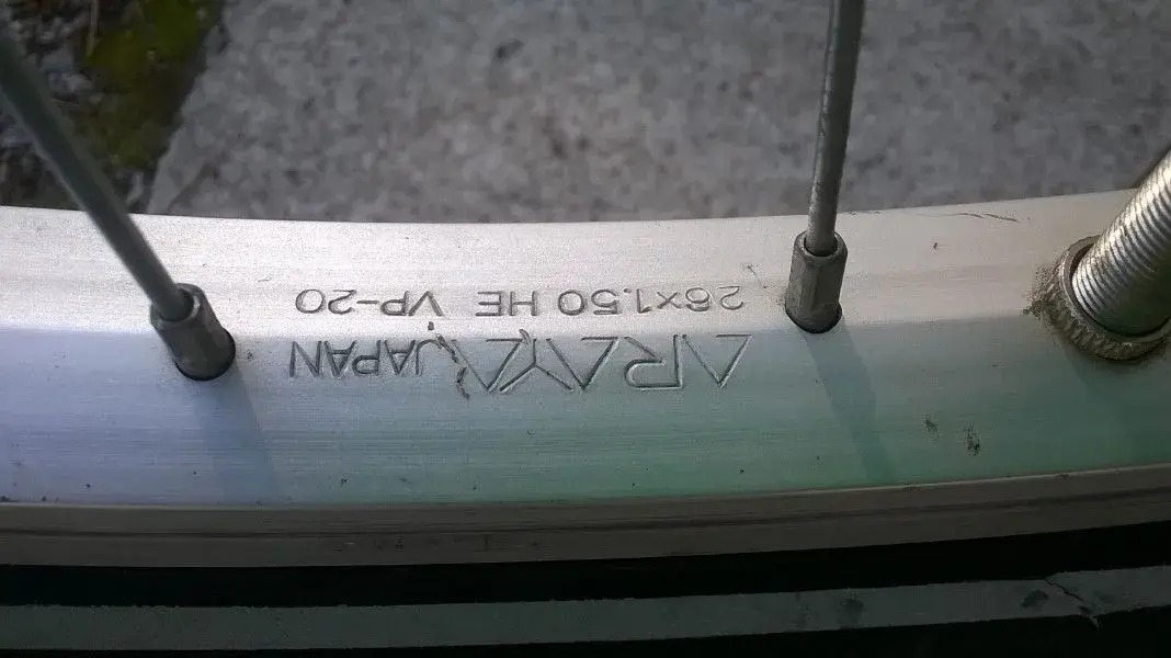

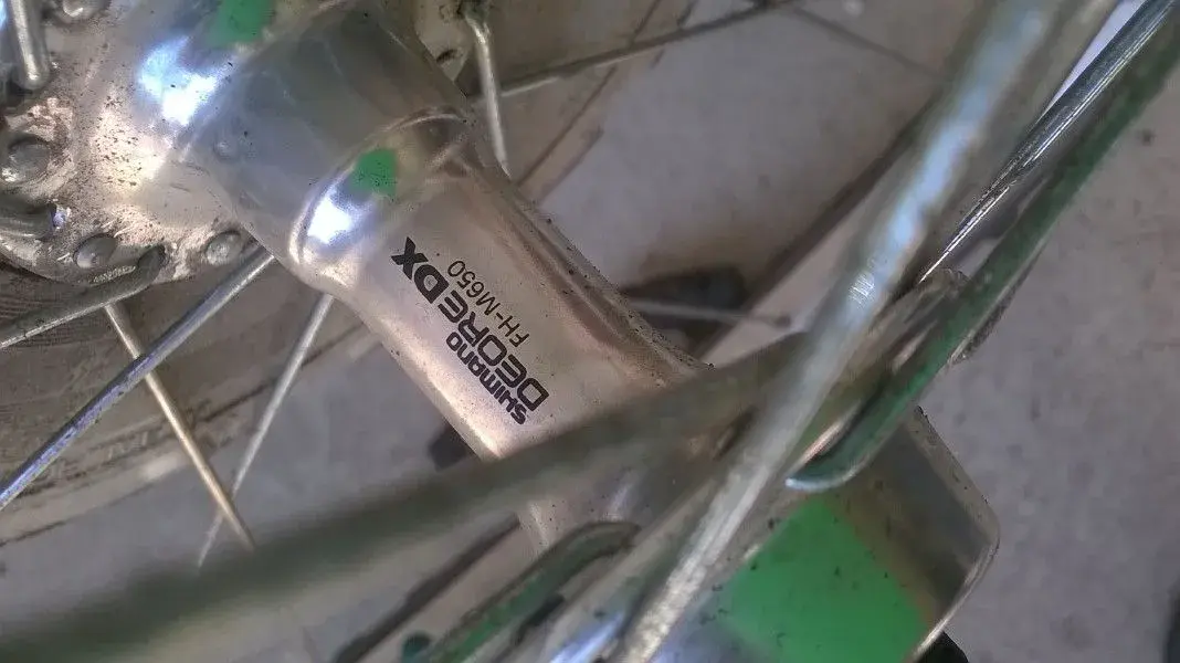

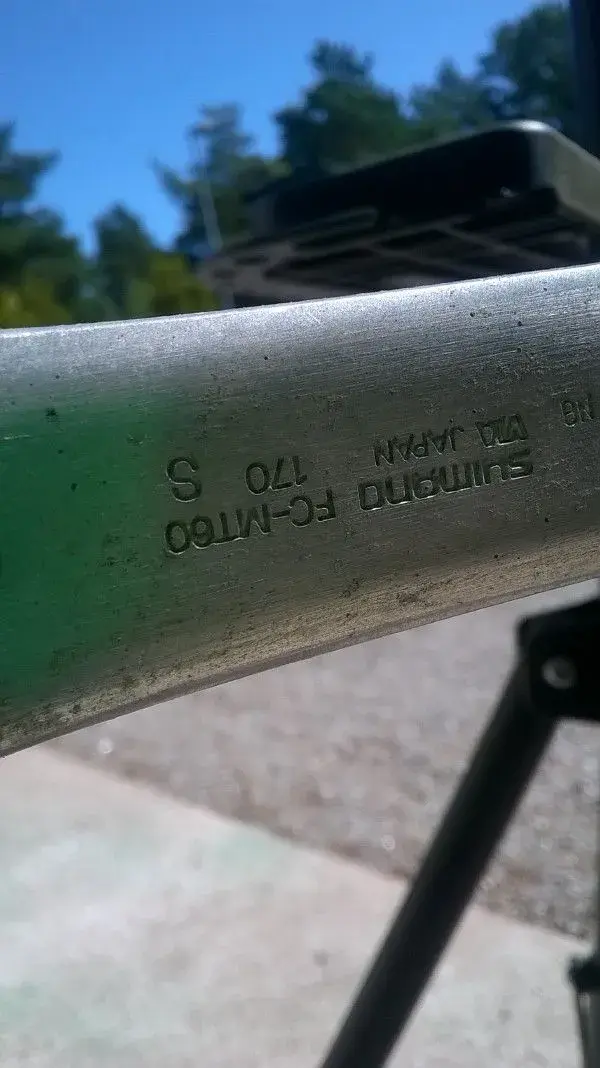

So I have worked a bit on the bike, new brake pads, new shift cables (inner as outer) to the rear mech and brakes (front not competed yet). As I did take the look off, I could see that the rear rim was damaged beone to be tuned wht just 3 new spokes that where missing. The rear hub, a DX M650
, was smooth, so as haped to have 2 spare Araya VP-20 rims form a old Marin Muirwoods (witch hubs where shoot) I did relpase that Araya RX-7 rim whit that. As hapen the front wheel seem to been replaced at some time, as it has a almost unused rim, same Araya VP-20 by the way, on a Exage RM50 hub that is low spec compare to the other bikes parts, but have to do.

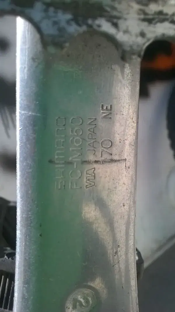

The other parts are mostly DX M650, aside the crank, witch left part is a MT60 Deore and right side a M650 DX, why I dont know.
The rear U-Brake I did not find any markings on aside text Deore.

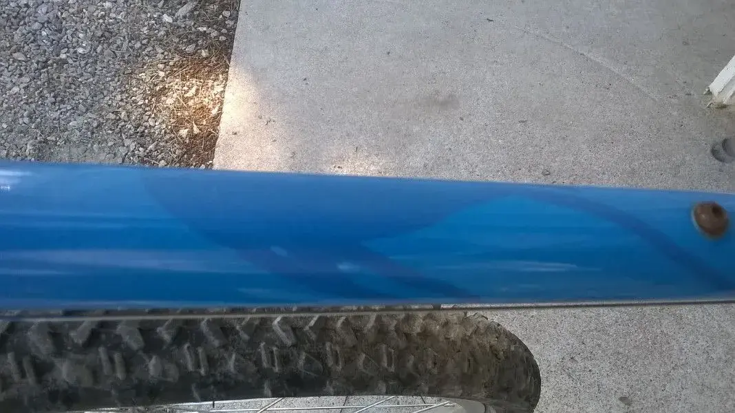

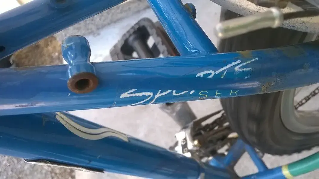

For the paint on the frame, here closeup on what the former owner has done

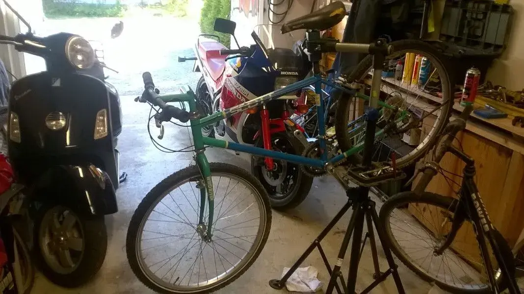

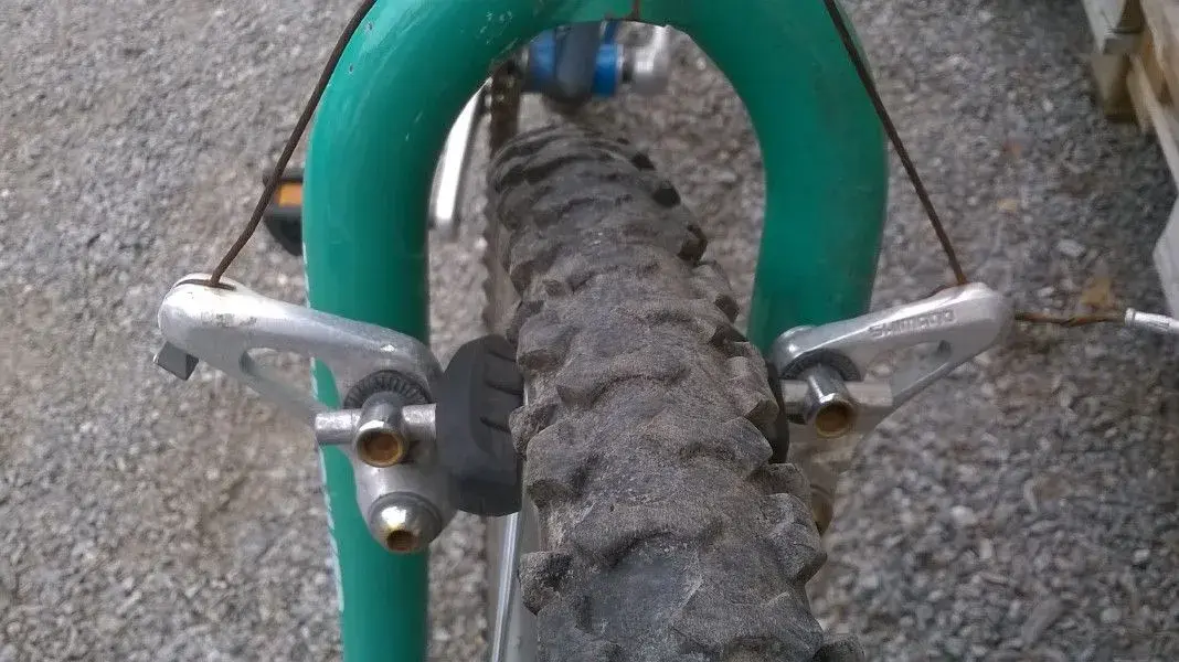

Front brake is sorted, now just need to find a new saddle before having a first ride
Thanks, its a 1985 Honda VF500FII.
Back to topic 8)
Had 2 rides whit it now, about 60km, works nice :D

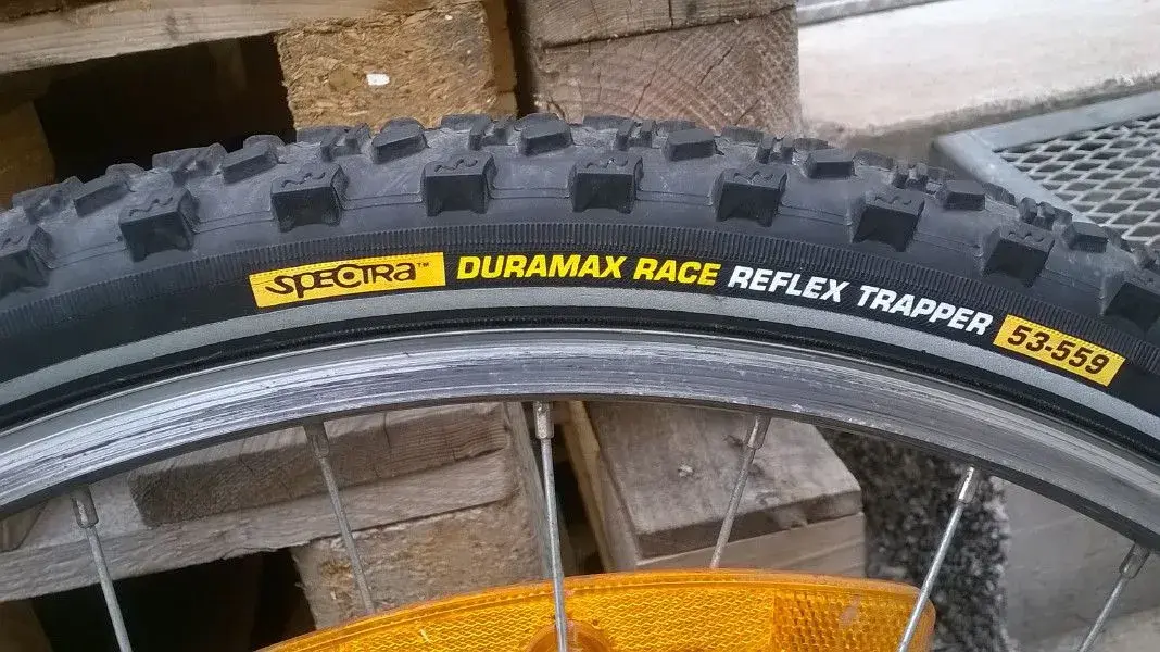

I do have to take off that side stand, it was ok first ride but second ride it started to bonce around, not nice. Then as the bike has budget tires (a Spectra front and a CST from a market bike rear) I have to look at some better tires, even the Spectra is made by same company as Maxxis....(Spectra is a Swedish Crescent brands aftermarket product brand, and for example their chains are KMC!) and as the rims need wire tires, I mainly think of Conti Race King (26x2,0) or Schwalbe Rapid Rob (26x2,1). I do have a set of Togia Factory XC tires in good nic, but might want something faster. Ok a bike of this age should get tan/amberwalls......UPDATE ordered a set of Splashback 1,8´s, migth swmp wheels whit the Marin splatter I have....

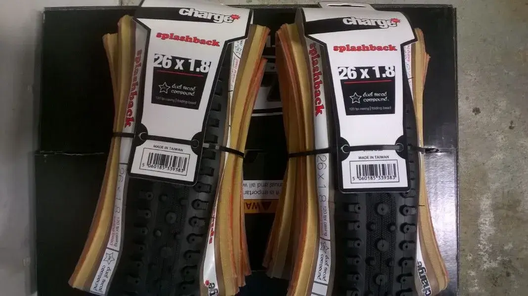

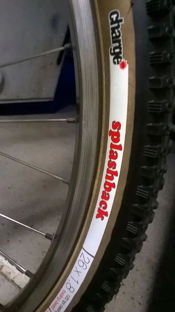

A update.
Wednesday a package whit some nice inside did arrive
A set of Charge Splatchback 26x1,8 tires.

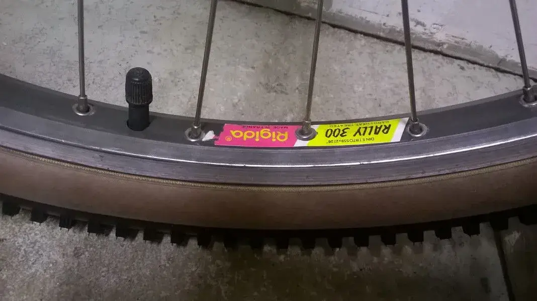

As they are folding, and better on other rims than the Araya VP-20, I swamped wheel whit my 1990 Marin Muirwoods "splatter". The Araya VP-20/Exage RM-50 front wheel is actually same as the Muirwood had as stock. Also this way the Windriver gets stock spec DX M650 hubs both front as rear. The rims are now Rigida Ralley 300 mounted whit Splashback tires.

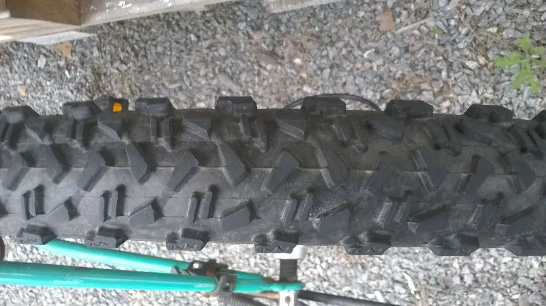

As I had mounted the tires I noticed that even the tread don´t seem directional, the sidewalls do have direction arrows
The tires was tight to fit, but easy to get straight on the rims. No issues like I have been reading off.
They fit the bike nice I think. Would proberly have order 2,1´s if they had been awable. I did not find a web shop whit them in stock.....

Nice work! 8)
Regarding the 2.1 Splashbacks, they are really big when mounted, so 1.8s are a better bet. And they obvoiusly aren't directional as you say.
