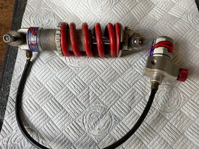

Oh yes , down here in Sunny Bournemouth !!!!!!!! send me a picture of your shock , if it's the same as the one I have you can have it , just cover the postage
Here is a photo of my shock. Yours may not have the second red adjuster (for Rebound) but even if it hasn't (and has just the one adjuster on the piggy back for Compression) it won’t matter. The shocks are the same in eye to eye length and are interchangeable. Letting me have the shock with no charge is very kind of you. Please let me know how much the postage would be and how you’d like this paid to you.

Found it ,not in the best of conditions , the hose on the shock looks a bit worst for wear , paint on the spring has seen better days , but I think all the bushes are there , are you still interested ?? any thing else you are in need of ? IMG_2287.webp
Hi. I think I say no to taking the shock, if that’s ok. With the condition of the hose it’s probable there’s been some loss of fluid. But thanh you for getting back to me, and your kind offer on the shock. I’m now veering towards buying a new 150x35 coil or a 165x35 air shock. While the 150 will fit easily (with some customising of the frame mounts to allow for larger diam bushes that all shocks seem to come with these days)), the 165 air will be a different story. It will require careful decisions on its orientation in the frame to ensure clearance on full compression hits, as well as additional brackets and possibly some offset bushes to accommodate the extra length while keeping the frame geometry. If I’m lucky the 165 shock and brackets will slacken the head angle a degree or two helping downhill control.
