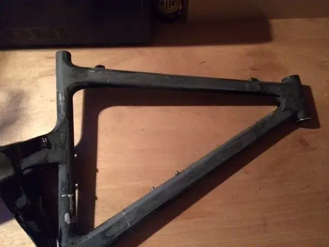

Been busy removing the paint from the frame. Quite successful while leaving the carbon fully intact. Done the RH side of the frame. Now off to the LH side, so almost finished. The frame will be covered by an expoxy primer and finished with a 200k topcoat in the colour Barents Blue (Volvo specific colour). Gil is on its way with new logo's.

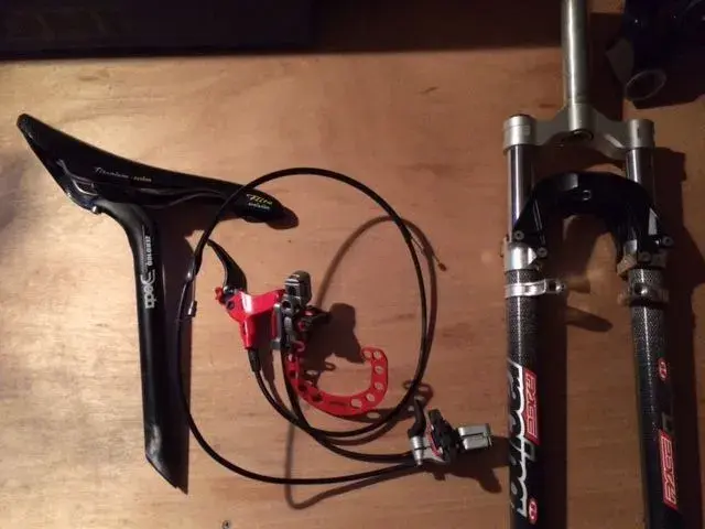

Have some nice parts collected to install on this frame. The crankset is a M739 that will be modified to accomodate 1x9 104bcd single ring. Shifting va SRAM XO on the rear (not period correct though...). Wheelset is a full black CODA700 to start with. Still looking for a nice stem. Carbon accents will be there 8) .

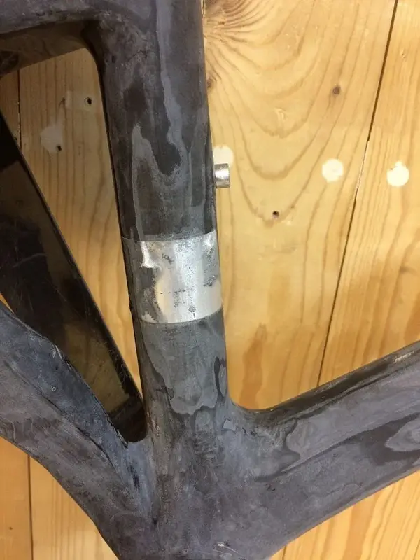

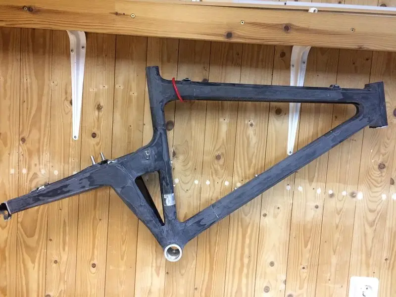

Spent last weekend some time for the last part of paint removal.
I see about 4 layers of paint;
1. tough clearcoat
2. black color coating
3. primer coating (black)
4. primer coating (dark grey).
When removing the paint, carefully use high grade sanding paper. Once the frame is removed from most of the paint, you will see several layers of carbon weave patterns. I could distinguish UD and 90/0 types on several places. Also you can see clearly the aluminum insert on the seat tube which acts as a reinforcement for the front derailleur.

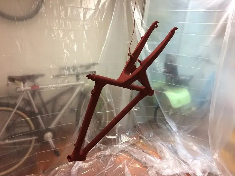

Hello guys,
Some progress to report...
Step 1 & Step 2. Step 3 will follow this evening.
