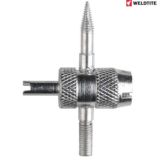

Or these Weldtite valve tools have a tap (and die) on them, but I've only ever used them for cleaning up, not fully tapping:
