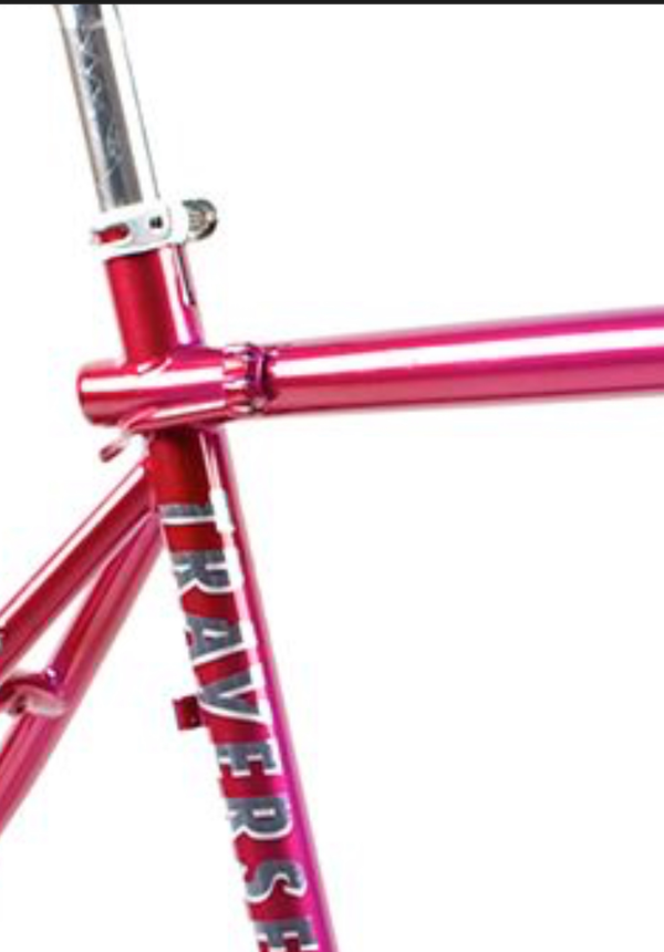

hi there.got a saracen traverse.looking to build it up but have an issue with the rear brake outer cable.was gonna try and fit a new one but having difficulty in removing old outer cable. where outer cable goes into frame its kinda stuck there.any advice much appreciated.thanks
In here? Cut the inner, and remove it, then tap the ferrule out , using a small drift,with the outer still attached. Or take the outer out of the ferrule and then get some mole grips and twist the ferrule out. IMG_1018.jpeg
thanks for info.yes its the internally cable. i wasnt sureif its one cable all the way through or two separate cables?
