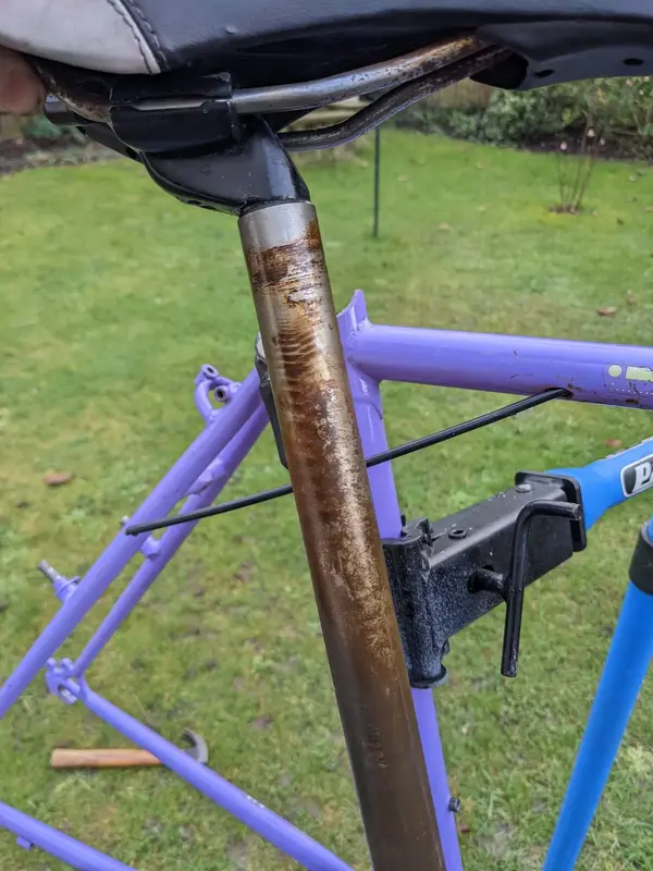

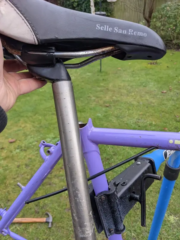

Had an attempt at getting the seatpost out this evening with absolutely no luck. Wouldn't budge. Did get the seat clamp moving again though.

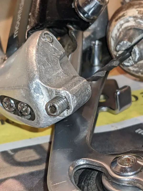

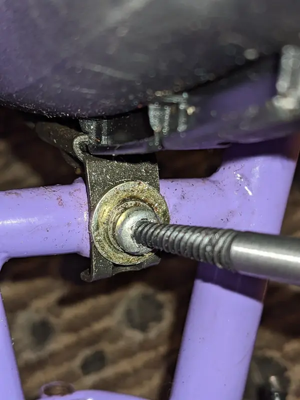

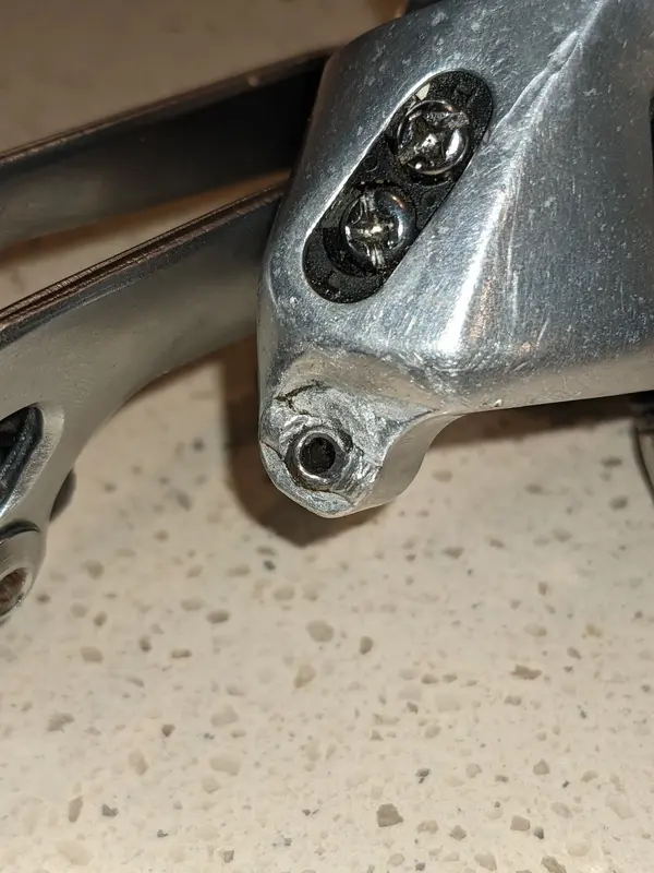

The screw holding the rear mudguard to the seatstay bridge was seized and threaded but has come out nicely by drilling into it and twisting in a screw extractor. Finished doing that, started cleaning the rear mech and the barrel adjuster crumbled apart in my hands, leaving half of it in the threads. After a bit of panicking I managed to slowly drill it out from the back with a 7/64" drillbit in reverse, being careful not to damage the internal threading of the mech.

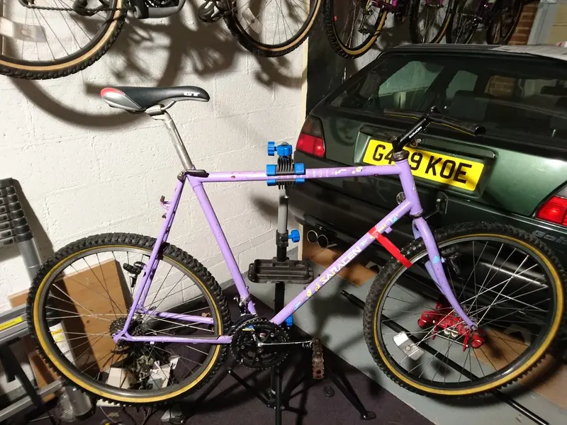

Yellow Jagwire cables, NOS LX brake pads and a cheap used pair of tanwall Wildgrippers off eBay ordered tonight. Not sure about pedals yet - might try and source some NOS Tioga Surefoots.
