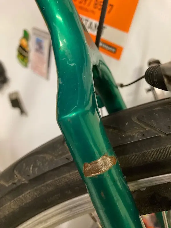

So.... good news!
I’ve managed to investigate the crack in the paint and it’s just a bit of ingress that has lifted paint.... thank the lord!
Anyway, I’m now thinking that I can simply dremmel it back, rust treatment and touch up. I’d still go full new PC but maybe I’m best off preserving the original paint which bar this blemish is pretty much spotless....
My mate is a pro motorcycle sprayer so could even get him to touch it in...
What’s peoples thoughts? Preserve and touch in or still PC it?
Cheers
Andy

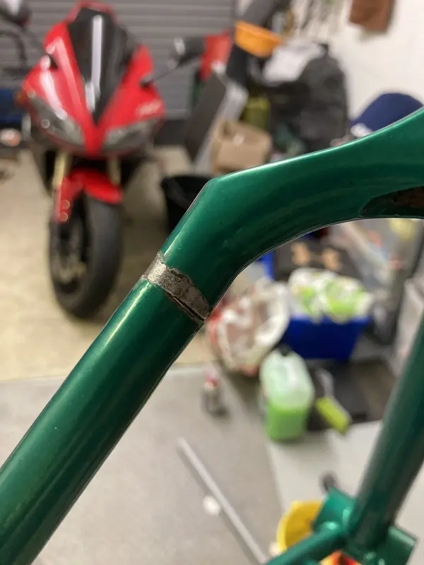

So… I can confidently confirm after a strip down, light filing of the minor corrosion that this appears to be surface corrosion at the brazing. A bit of a ridge/groove at the brazing I thing has caused this over time… no flexing whatsoever and no light from a torch penetrating the area.
So I’ll remove the surface corrosion, touch it in and rebuild the bike to my usual minty high ‘eat your dinner off it’ standard 👍😎
