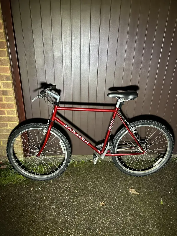

I’ve been out on the bike at the weekend and I could do with the handlebars being higher. Have you got any stem/handle bar recommendations? I’ve been looking online but I thought I’d ask? Thanks
Might be good to post up a photo of the bike as it is now (side view) so we can see saddle/bar set up as it is now..
Chances are a shorter stem, maybe with a bit more rise, would help.
You could also put on a riser bar with some back-sweep in place of the flat bar. The rise will move your hand upwards. The back-sweep will move them closer to you. Both will give a more upright position.
Like I said it just feels like you’re slightly leaning forward on it with my weight on my wrists. I’d just prefer it if it could be a bit more up right
Try some riser bars if you can? Where are you based? If you're anywhere near me (M1 j26) I've a dozen or more bars you could try.
Earlier comment about twisting them too is a great free idea, I reckon my Karakoram bars are twisted slightly more forward than yours. Little things.
