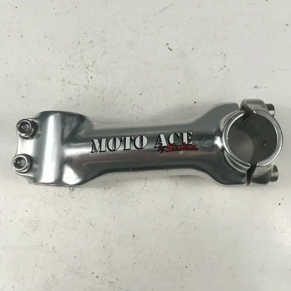

I found a cheap Salsa Moto Ace stem on eBay which is on its way -- should work nicely.

Well the stem arrived and it's for a 1" steerer! My bad record on eBay continues.
