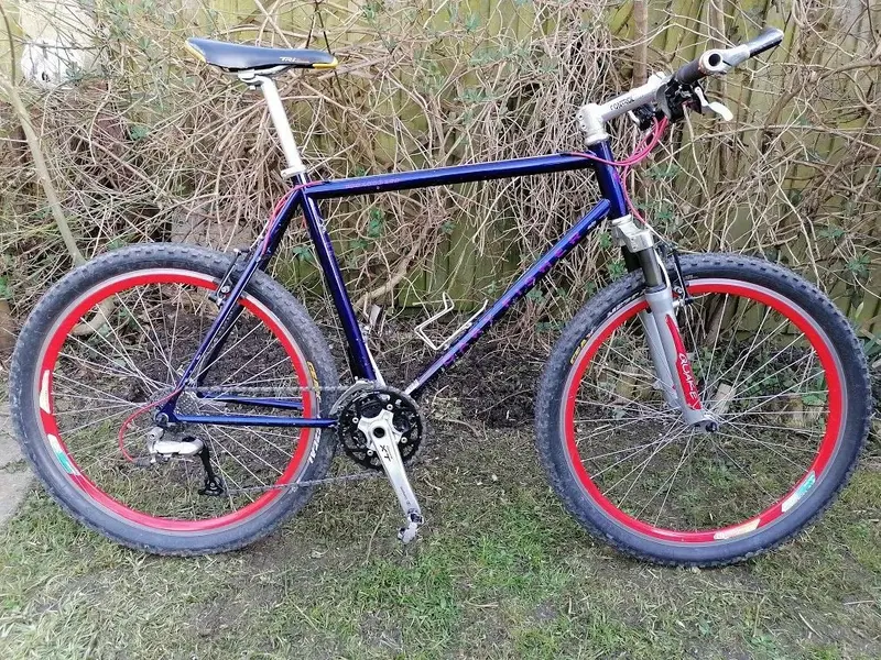

Any other bike is ripe for making more modern though, most recently an old Hardrock that got a shorter stem and 700mm bars, and lock on grips that can help extend the bar another 20mm at least. I found wider 25.4mm Riser bars to be a bit flexible, so it now has some even more modern 31.8 diameter bars.
look at that moron with his long stem and bar ends!
Oh, wait, thats me this afternoon :oops:
