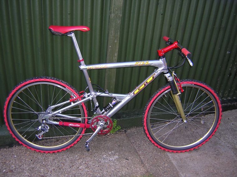

I run a Judy SL on mine (1995) and have so for some time now. It originaly came with Mag 21's.
Have used the standard 63mm and the long travel kit of 80mm with no problems and have not noticed any difference in the ride.....
Hope this helps....
Hope this helps....
