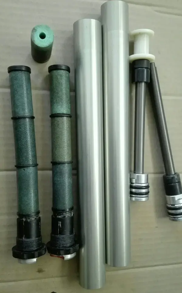

Those are the elastomer stacks, the stanchions and the push rods from my defunct RST Mozo Pro 1998-1999 (I guess).
They held up pretty well, the MCU dosn't desintegrate maybe because they were kept în a plastic bag for the last 15 years? :roll:
The fork looked slighty different than yours, I guess it was an older model, my knowledge on RST forks is pretty limited.

That is a newer Mozo pro with air based dampener. The fork of the TO is older. Same Elastomere stacks thou.
