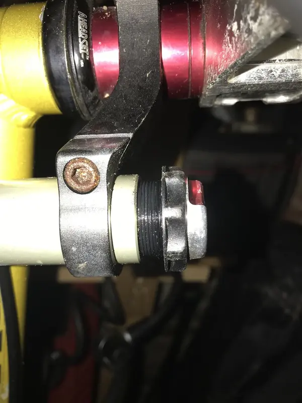

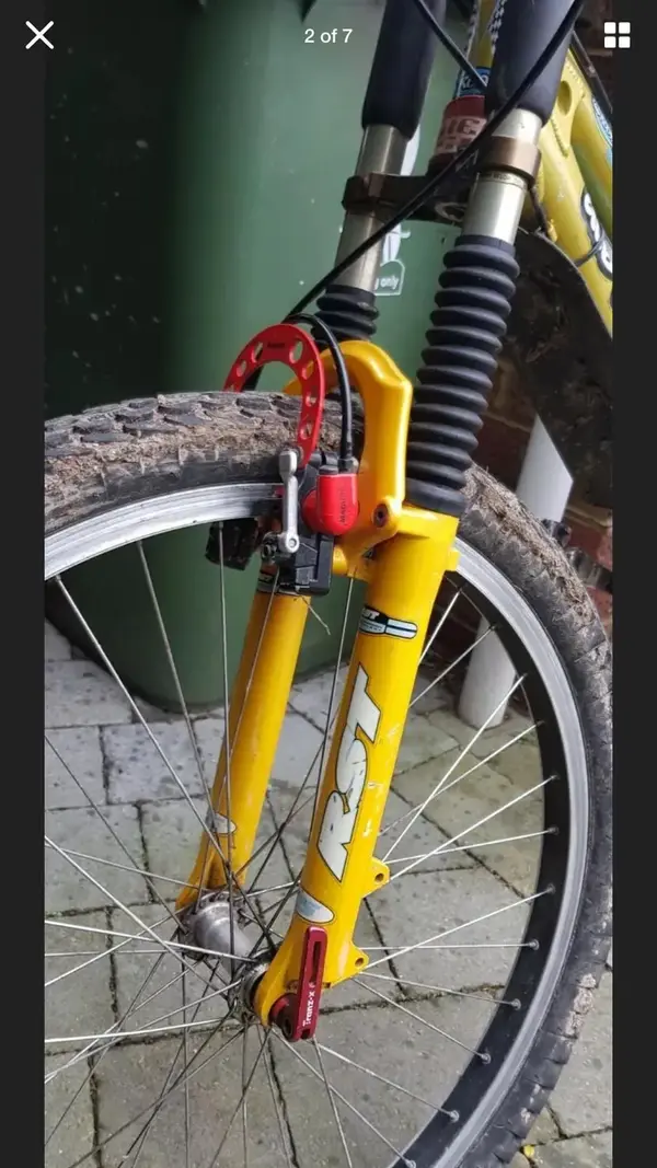

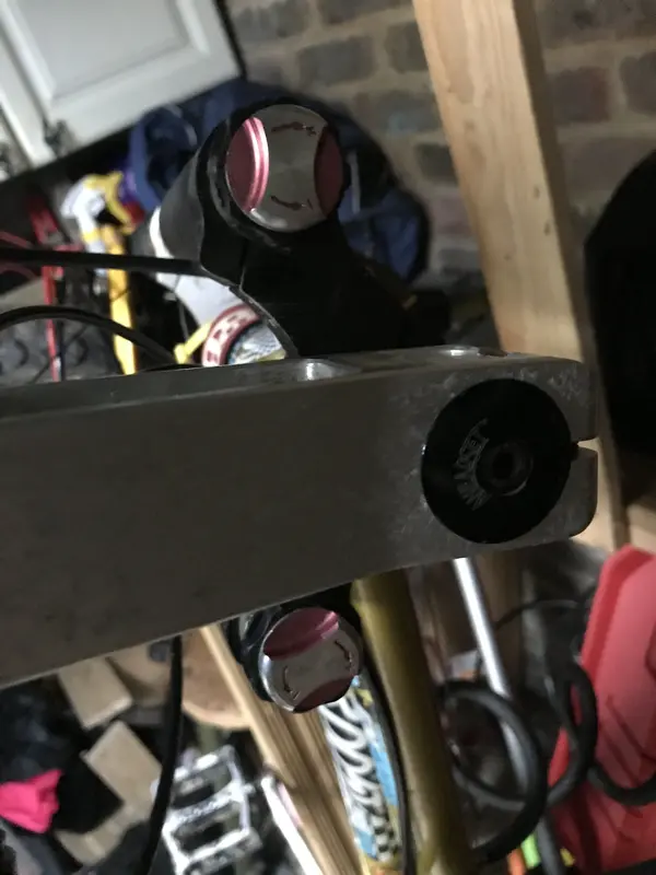

Hi all I’m new to this so bear with lol I have a set of rst hi5 forks that I got with the bike I’ve just brought (club roost Dh ) that are just to bouncey for my likening I was wounding how to stiffer up the forks

I've an old set of those too. I'd guess they will likely need a rebuild as they weren't terribly good new - apparently...
Hi yer there just really really bouncey to a point where I can’t use them I was thinking was there away of getting them stiffer if so what do I need to do to them as I’m assuming there not air forks
I had a set when they first came out and at the time were a good way to get long travel on the cheap.Very simple internals as its an elastomer fork.Check out the state of the elastomer stack,clean it up and stick in some new lube.They are rough and ready,dont expect Z1 performance but I used mine specifically for downhilling and big hits,I found it fine for that.
We had a set on one of our downhill bikes when they came out. I think there is an air damper in the bottom of one or both legs. Check the bottom of the fork legs for an allen bolt adjuster.
We stripped ours down and rebuilt them using grease etc... and they worked a lot better. But there was an issue with some of them snapping, I think it was the steerer. I'm fairly certain they were all recalled and fixed. Still worth taking it a bit cautiously.

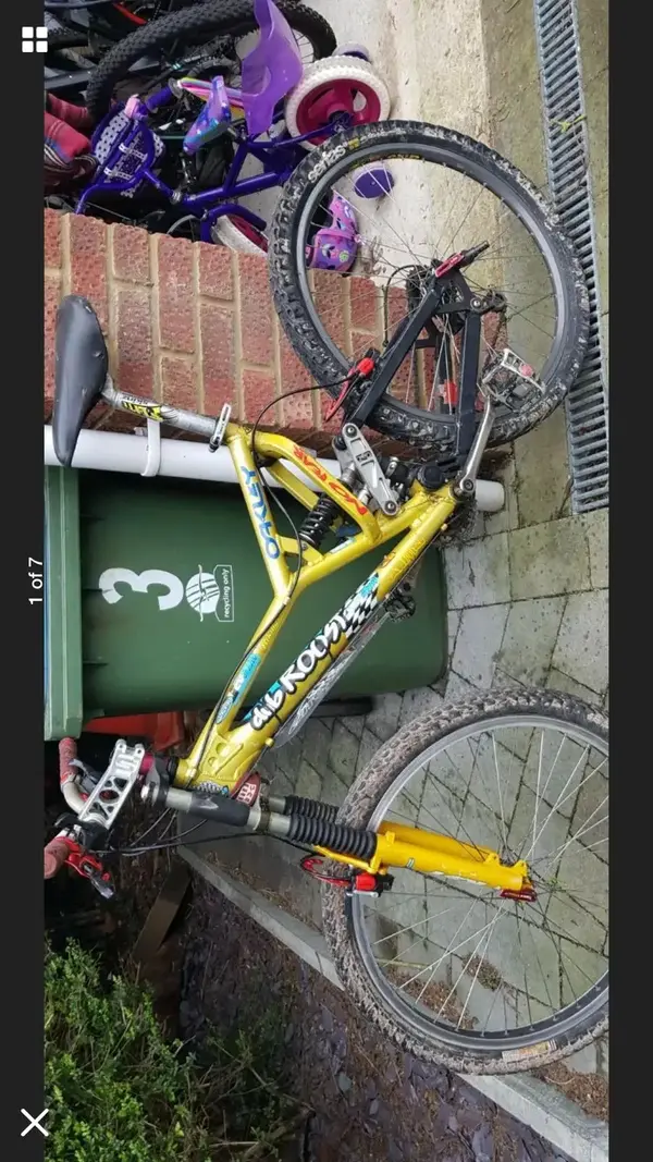

Hi just added a photo of the bike I’m not after a get if down hill forks anymore just want to change them with a set with v brake mounts on then
