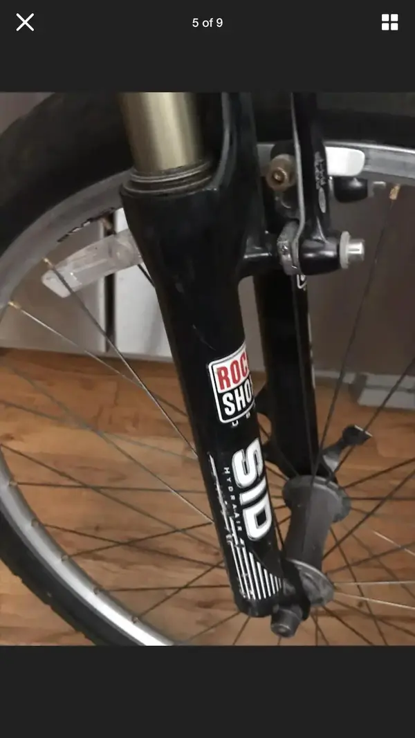

Yer it’s what I have found online but I’m going for these I think
The SID is an XC fork, it'll fit, and the brakes will fit, but it's like using a squash racket to play baseball...
I’m not after really bouncey forks tbo as I’m not doing downhill properly and as these seem to be the only style fork that fits
Those Hi5 forks were terrible even new
Don’t put a SID on that as it’ll be wierd to ride
Buy a Z1 or junior T or something matching. There are loads out there
A junior T would be best bet on that frame and are relatively cheap.
