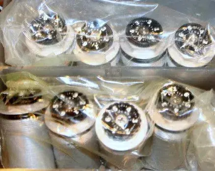

That's not used on the 1994 MAG btw ;)
That picture is pretty much the same as the MAG20 or the 1993 MAG21 (and the MAG30/1993 MAG10 also used a long sided version as well)
