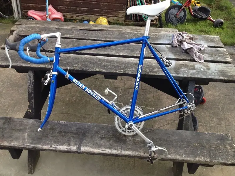

Another of Stoke's finest has found its way from eBay into my garage
Waiting for delivery but looks ok from the pictures. From the frame number, it looks like a 90s frame and is equipped with Shimano 105. OLD is I understand 130mm and is just missing a pair of wheels. The chrome looks in great order (Their chroming was, I believe, historically done in Leeds and really stands the test of time).
Its always a bit of a lottery with eBay and I have had a couple of nightmares but at £140, I thought it was worth a punt

Great find. I always wondered how such lovely bikes could come from such a grim city. Lovely angle on that top tube, and the chrome dropouts are a nice touch. Not so struck on the saddle though.
Has it been ridden much? Everything looks pretty new - maybe those chips are from storage rather than riding?
Well its turned up and is and there's no dings or cracks. Interestingly, after speaking to Gaz at Rourke's I got loads of info:
Head angle 73
Seat angle 72
130mm OLN
Reynolds 531C F&F
Cinelli sloping fork crown & BB & cast lugs
Date of Mfr: 29 Sept 1995
Its a bit newer than I had anticipated so just thinking about what to build it up with. I don't fancy C1995 kit so may go earlier - maybe C-Record era or maybe Dura Ace 6400. I've even thought about going contemporary with a 10 speed Veloce black groupset from Ribble.
Colour wise, I'm toying with the idea of Molteni orange with pearl blue panels yellow decals - Project " when Eddy met Brian"

Just collected it from Rourkes with a fresh coat of paint. I'll get a picture up in a moment then start a build thread
