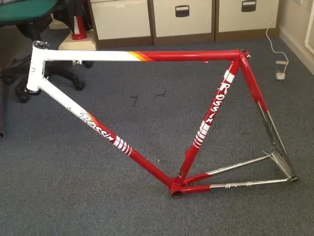

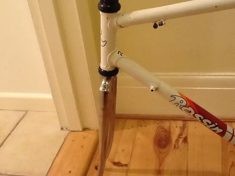

I am just building up an old Rossin its probably mid 80's Columbus SL , the serial numbers for most are stamped on the rear dropout left side mine is K1 210 although from what I understand these are random almost.
Has anyone seen one in these colours before ? Also it has a race number hanger which is not so common.
Its hopefully going for a respray in Jan/Feb to Argos bikes in Bristol but the current paint is grwoing on me so I may keep the same colour scheme just in new paint.

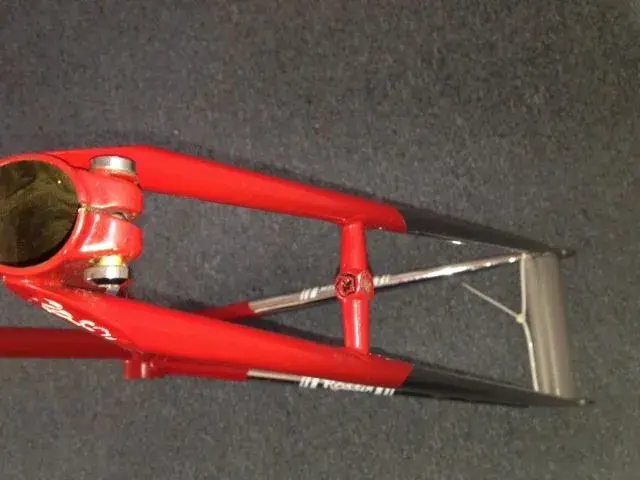

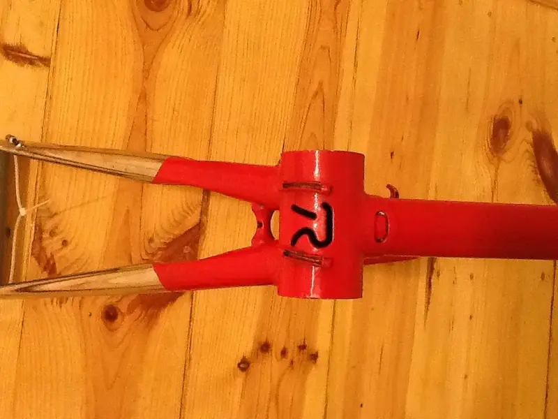

BB with "R" cutout and cable guides, the earlier 80's and late 70 Rossins often had teh cable guides above the BB and on top of the rear chain stay.

Have you any info about BB cable routing, you mention routing over BB in 70's and your BB has the cut out 'R', mine has the cables routing through the BB.

In the first pic, the bike has not got the race plate boss strangely. What I really want to know is the history of the BB design. It appears to be -
1. Cables over BB
2. Cables through BB
3. Cables under cut out 'R' BB with guides
If the above is accurate, any idea of the years?

Sorry for the delay from what I can tell, the BB setup was typically:
late 70's -early 80's Cables over BB
Early 80's Cables under BB
Mid to late 80's cables through BB
You also tend to see the cable through the top tube in the late 80's whereas the early to mid 80's have the cables normally along the top tube.
Mine seems to be different hear in that mine has the cables on the side of the top tube.
