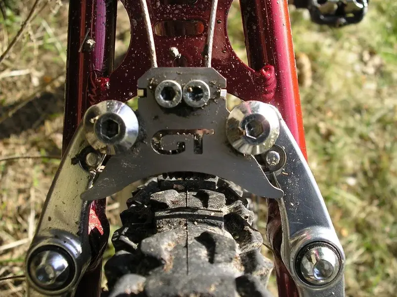

Has anyone ever put a roller cam on a GT before? Thinking of trying it on a Xizang to better compliment a XC Pro MD group set. :?
yep, wrap the straddle cable around the seat tube, connect the two ends to the cam. I've got some pictures somewhere, will have a look.

Thanks for the info - pics would be great :D
I've done it too BITD, same method....will find pics.

This is the only picture I can find, the guy that sold the roller cam to me had great pictures from a Zaskar, but basically you use the Ubrake cable seat tube cable guide.
