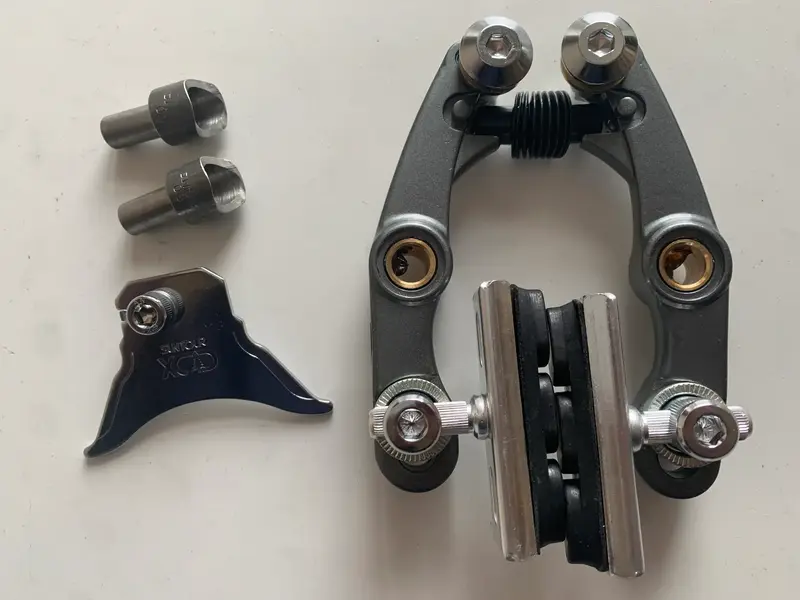

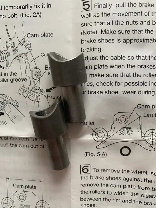

Hi, Iove to see that detail about the pivot spacing if you'd be willing to take a pic sometime, please?
The pivots that came with XCD 6000's are designed to be mounted either slightly inside or outside the chain stay , depending on
which way round you fit them , also the shape of the chain stay itself . The rim width is the other major consideration
If you let me know your intended rim width I will check out the ideal position of the pivots based on new brake blocks set up in mid position
You would expect that the installation instructions that came with the brakes would include the dimensions required to enable the frame
builder to correctly position the pivots , that is not the case . The link above does give a dimension in the Japanese translation , but this
is of no great help . I will measure the pivot positions on the Muddy Fox Trailblazer and get back to you

Thanks so much for the photos. Yes i agree on the pivot spacing info, seems odd. The info will be out there somewhere, or I could just measure them on my tandem which would take about 1 minute. Hah.
Have a pair of Velocity Atlas sitting around that seem like they'd be good for it, although a bit on the heavy side...
External width of these is 25.4 apparently.
So my measure said 87mm c-c for the pivots. I'm riding a 30mm ext rim on the tandem. The brakepads' grippy posts are pushed fairly far outwards, so the same pivot setup would work with those 2.5mm ish slightly inward for the Atlas rim. On that tandem I've got 2.15" maxxis dth tyres, SKS mudguards not too close to the tyres, and it all *just* fits under brake cam. For the single I'm planning I'll use skinneier tyres, thinking up to 40c, and I'd like max mud clearance under the guards, so the bottom of the cam is likely to be the limiting factor for clearance. I guess the pivots can't be positioned higher than as the brake pads have no height adjustment possible, unless I mess about with offsetting brake pads somehow, further away from the pivots (not a great idea, esp cos less leverage).
With the brass rollers set at 44mm centres ( as per instructions ) ie . at the bottom/start of the cam and using moulded Suntour brakepads
in their middle adjustment position and rims with braking surfaces 25mm apart , the pivots are then on 87mm centres .
These measurements taken from a Muddy Fox Trailblazer 1989 , the pivots are offset 'out' to achieve the 87mm dimension
