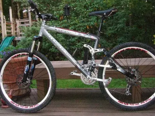

specs for my 2003 etsx-70. approx weight of my 16.5" build is 27lbs. i'm 5'8" with 30" inseem, and could do with a little more stand-over height.

lid do you want to sned us the spec details of your bike id love to seee how you have managed to get it to weigh 23.5lb was it?
i believe someone on another forum managed to get an ETSX down to approx 24-25lbs, but that was with a lot of carbon and other light weight parts. i did a quick search but can't seem to find the thread.
That was with the Wu scales. I guess its about 26 or so with the Talas front end, older 4 pot xt discs. I have put big 2.4s on it for really scarry North Shore stuff.

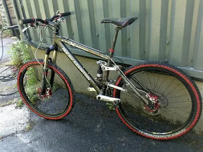

Seems odd that you guys that are taller than me are ridding smaller frames and having standover probs? I am normal in proportions.....though have been told that my mouth is too big......a few times. I am also running a much shorter stem than anyone-everyone else??
