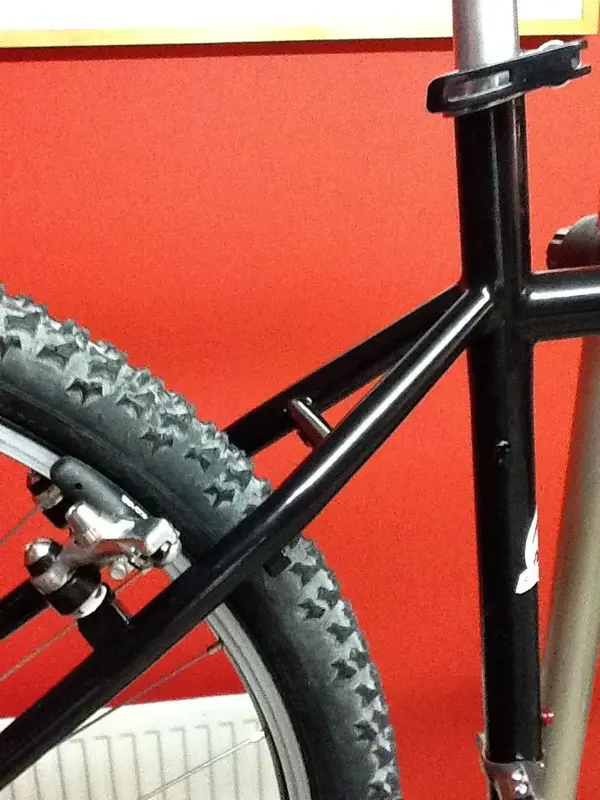

Weird isn't it ?
I just wonder if it was like it from the start
I bought it from Gump who used to be an RM Team rider ...could it have been made late 95 to trial v's ? Might explain the lack of a frame number.
I have sourced some Xtr 951 v's from one of the guys :lol:
Thanks Ed
Build back on......
I think frame number are still on there for the team, rocky need to keep track of them somehow.
Frame numbers are either filed off or hidden somewhere else on the bikes. They are not always on the bottom bracket as far as I know.
But couldn't prove that. Ask Rocky someone there may know.
Test frames will have been in Canada, bit of a long way to ship a test frame to the small team over here ?
captaincosmic":o0y02hxb said:
Yep just looking at one now looks like an ibis hand job and the seat collar is straight too
Must have been removed then so v brakes then :cry:
v brakes steve... really . not a proper biizzard :lol:
I know :oops:

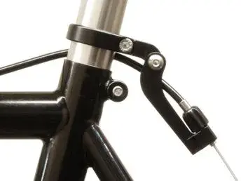

Just been on the Pauls components site and they do a seatpost mounted rear brake hanger but I just think there will be too much flex in the whole setup and the brakes will be spongey and innefective.

Just ordered a Pauls Funky Monkey

The bit cost $48 and the postage $37 :shock:
