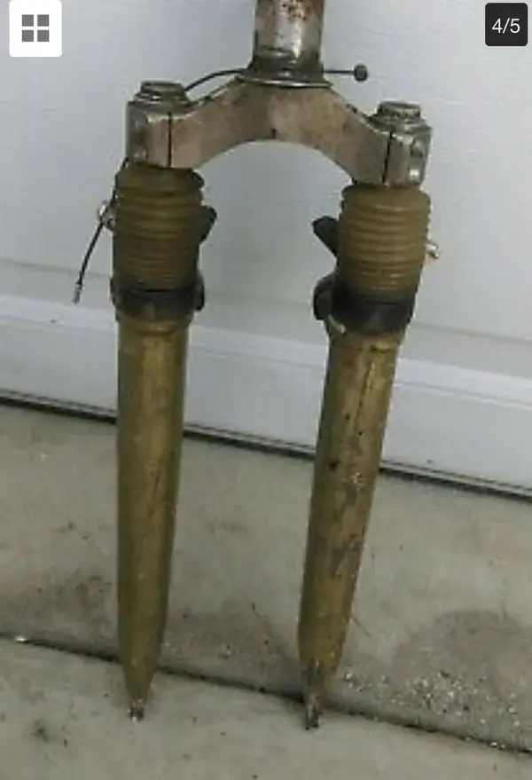

Evening all. I've got some RockShox forks here, That I am trying to identify: https://imgur.com/a/iOX2sJl
They were sold to me as Mag 21's, but they don't inspire me with confidence, as all of the gold paint is coming off on my grubby mits.
I'd like to know what I have, as I would like to put the "right" parts on my new rebuild.

I have incorporated your photos into my post as it make looking at the photos for everyone so much easier. Looks like MAG 21 to me.

look to be 1993 mag21, crown/steerer is probably later.
do you have a picture from the rear, the area behind the brace mounts.
that's the definitive sign between 20/21 seris.

actually that brace is bothering me, that actually looks to be a Mag20 brace.
the part behind the mounting bolts, are they actually for recessed bolts?
which will be why the goldish fork colour looks like it does
need that rear view.
mag20 have a defined step there, the 21 doesn't.
if you can show a pic from behind of the upper part of the legs, that's the major tell for the difference between a 1992 Mag 20 and a 1993 Mag 21... it's the degree of taper at about 1 or 2 inches down on the gold leg.
Mag20
1992
Seals etc are the same, bushes are different.

Last picture makes it certain though.

Bumping thread with identical question. Yes it came from Dave Jones locker... but is it mag 20 or 21?
