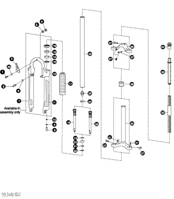

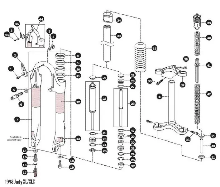

Thanks for the article Thias that maybe what I'm after. I don't have the forks available at the moment to take photos but attached are the exploded diagrams from the manuals. The insides of the XLC forks look similar to XC's with the addition of a spacer rod, but I think the springs might be different as they're 'long travel' (don't know what that actually means).
There's an obvious difference in hardware from 98 to 99 but I'm not sure if they're interchangeable

But to me it seems, the '99 parts should fit your XLC. You would have to take the lower bolts and the dampening assemblys (Parts 8+9+10 + 18 to 25 in the upper picture) from any '99 XC. Keep your springs. And add a seal (o-ring) to the lower bolt inside the casting, as I described it in the wiki. (If there isn't one already.
