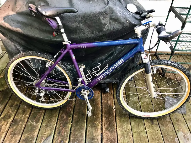

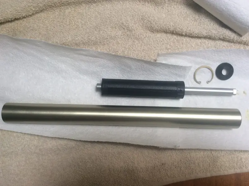

I’m in the same position at Trekybiker — just pulled apart my ’96 Judy XC/Cantis (original owner) from my 94 1/2 Cannondale, and the elastomers were toast. A real pita to clean out. Pulled everything apart for a thorough inspection and cleaning to find the stanchions in nearly immaculate condition. Oddly, no “Wavy” spring in the damper side under the snap ring?
Purchasing new springs from SRP to replace the elastomers are an easy, inexpensive fix!
However, my plastic damper has long since lost its oil and I”m dithering about buying the SRP oil damper kit as the instructions from the Judy manual on doing so aren’t particularly clear (and the small, grainy pictures aren’t helpful). Read a few posts on the process (several times) that didn’t clear up the fog and couldn’t find a youtube video of someone tackling it, either. And if I were able to manage it, how long would it last?

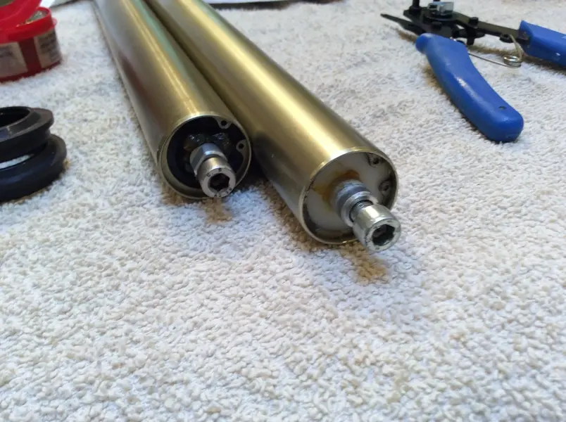

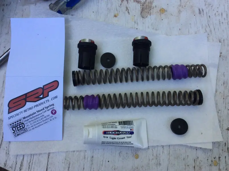

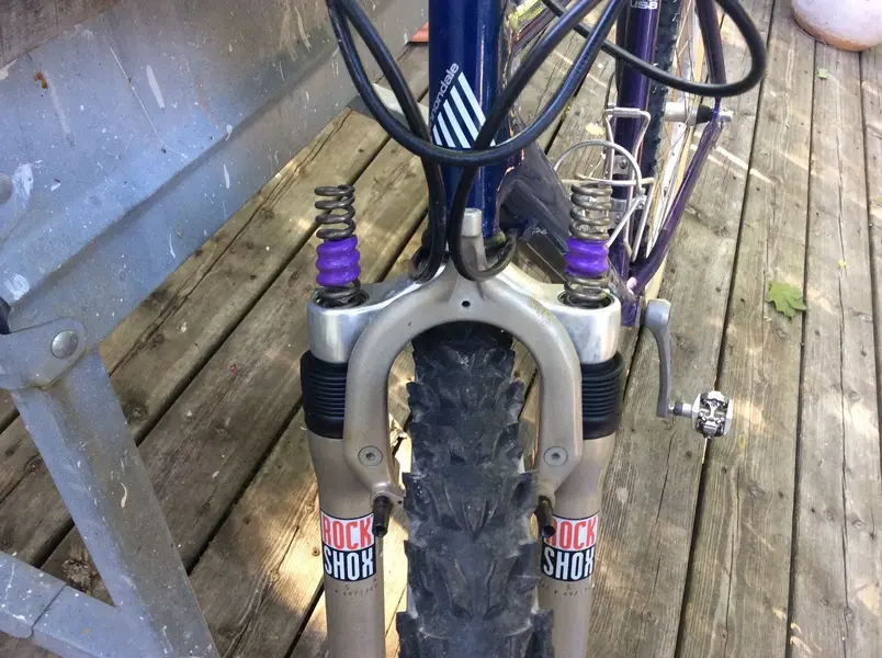

Yes I did. Just cleaned up the empty oil damper (non-drive side), lubbed lightly and installed. I went with the SRP Purple springs (I'm ~190lbs) and added the black stiffening spacers (probably not necessary), lubbed everything, especially the two bushings inside the lowers, gave the new springs a good coat of Slickoleum (included) and screwed them home with the top caps. Takes a bit of effort compressing the spring to screw in the top caps. Wow, great spring with minimal pogoing from lack of damping. So far, thrilled with result. Spring rate even improved after a few rides. Haven't been on anything really gnarly, yet. I'll consider having SRP rebuild the oil damper once they finish the prototype. Worked fine without so far.

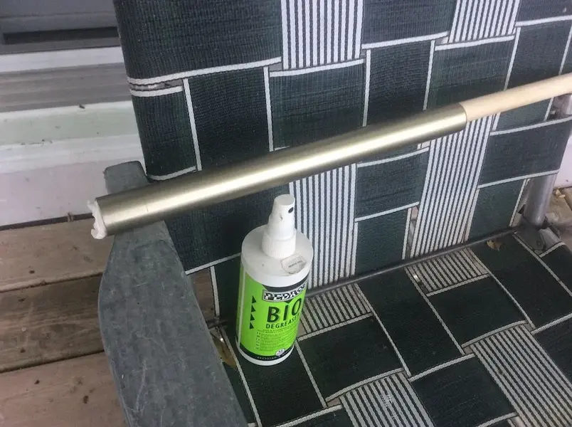

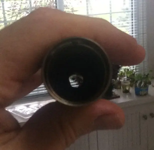

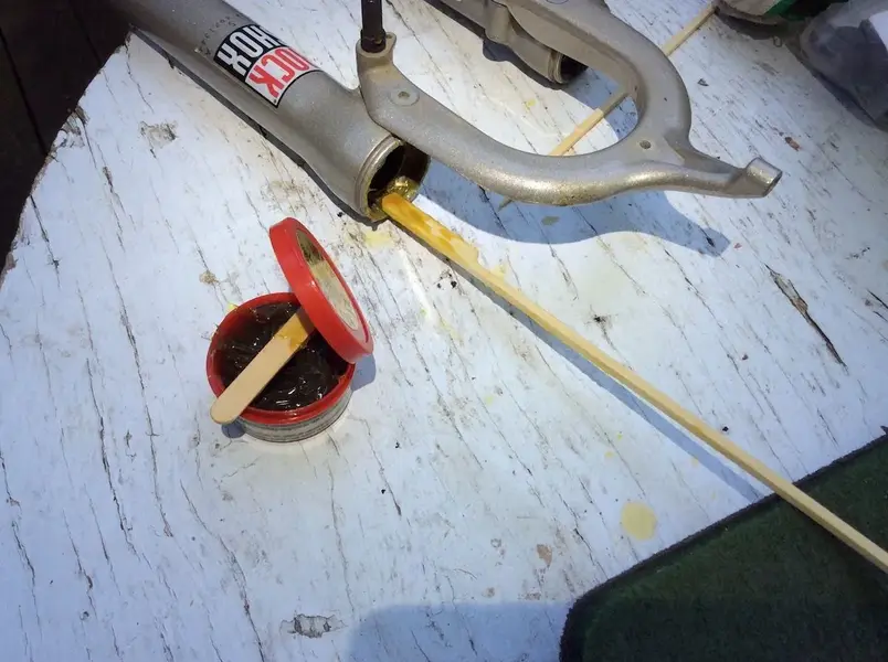

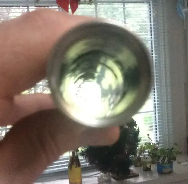

I was quite surprised to find everything pretty much immaculate. Tons and tons of miles in mostly dry and dusty conditions. Strangely, no Wavey spring when I took it apart. Getting the elastomer residue off of the inside of the uppers was the biggest PITA of all. Ended up finding a thick dowel nearly the same ID as the tube removed the most tenacious bits without risk of damaging the inside surface. Used every tool imaginable until it was pristine. For your corrosion, you might try grits of 1000>2000>3000?

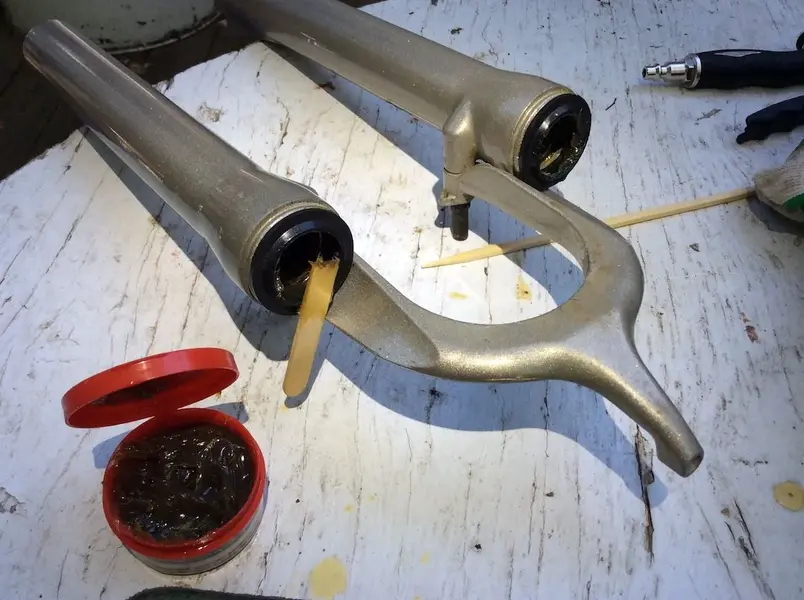

I had an unopened jar of Judy butter and was liberal with it (especially on the lower bushing). Slickoleum would work as well I think. Cleaned everything w/degreaser, 70% rubbing alcohol, then lubed.
Had planned to strip it to the frame, restore/replace anything and sell it. But, enjoying it too much now to let it go. Just need to locate a shorter 1-inch alloy stem (not thrilled about using a 1 1/8" w/a shim).
