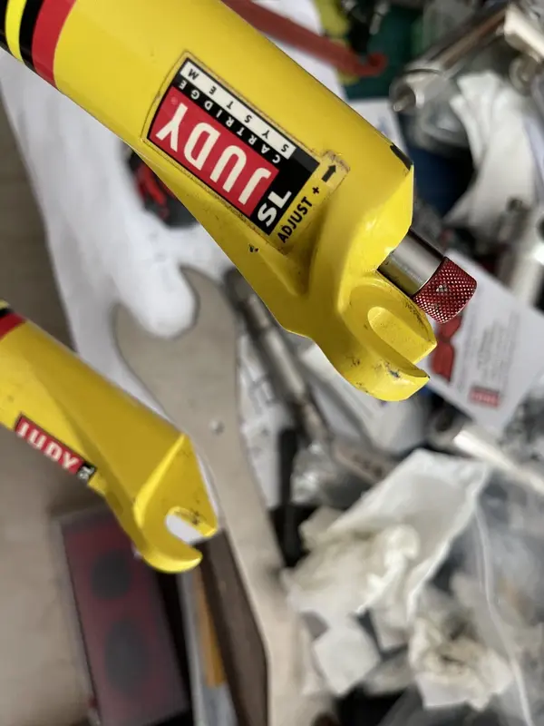

I just got a 1” Judy SL. Uncut steer tube, yellow - not sure of the year. The elastomers seem fine - but I wanted to open it to take a look. The cartridge leg has an aluminum knob in the lower that doesn’t come off. How do I remove the lowers when one side doesn’t seem to have the pull away knob/allen bolt underneath setup?
The red bit?
Pull it out, or grab it with pliers(protect it if you want) or a thin blade to separate.
It's just an o-ring and friction that holds it in place.
The red bit?

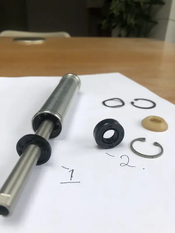

I am just trying to reassemble the cartridge side of my Judy SL’s. Can anyone help with the order - I didn’t take enough photos and now forgotten what went where - all diagrams seem slightly different to what I remove. Please see photo I took the clip washer off to clean inside the cartridge

The red bit?
Thanks - it worked. The o ring was swollen - had to pry very hard with the screwdriver - and it flew out....
