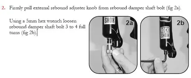

From the manuals I managed to get from Rock Shox website, there is an adjuster that fits on to an allen bolt which screws into the right hand fork leg.
How is the adjuster meant to work? The service manual states that is pushed on to the bolt. The adjuster is meant to be turned to set the rebound damping but surely all that does is to do up or undo the bolt thus letting the oil out of the leg? The bolt has a nylon washer and alloy cup.
Photo from service manual:
In the photo I can't quite work out if the bolt is hollow and the adjuster has a long central bit that goes through the bolt and into the fork gubbins - that would make sense to me.

Does the rebound adjuster actually do anything?? I can twiddle my knob All day without any difference at all.

Make sure its not a Hydra air SID as the 'adjuster' under the leg on these is actually a cover for the air valve for pumping the rebound adjuster. The plastic knob will turn endlessly doing nothing at all.
Just a thought.
Jamie
hydra air
Hi mate
I got that a bit mixed up now I read it back :oops:
Hydra air has a small spring in the bottom of the left hand dropout that controls the negative function. This is non adjustable and the plastic cover just covers a bolt that blanks of the air adjuster hole used on the other SID models.
For rebound damping adjustment, ( a damping screw) this is at the bottom of the right hand leg for hydra airs, clockwise increases damping, anti - clockwise decreases damping.
Hope this helps
Jamie
