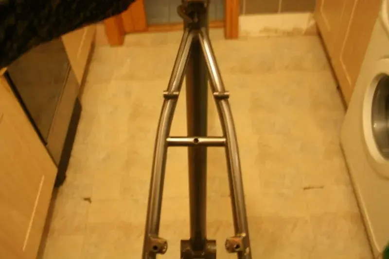

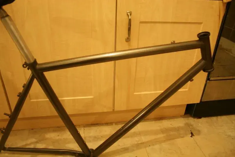

Pretty much stripped the frame tonight, quick clean and degrease tomorrow and it'll be getting blued tomorrow night. Was hoping to have it blued today but its taken longer than i thought to strip.
many thanks again

Pics of the frame below, looks lighter in the pics than it is, once built I'll get some pics taken outside where hopefully the finish will be more lifelike in the photo's.

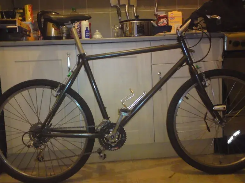

Alreet Folks,
managed to get phone synched to pc so here's a quick update. Still not too happy with the finish, but it'll have to do for the time being as need to get miles in for the C2C next month, I might strip and respray her when I get back.
Thanks again for looking
