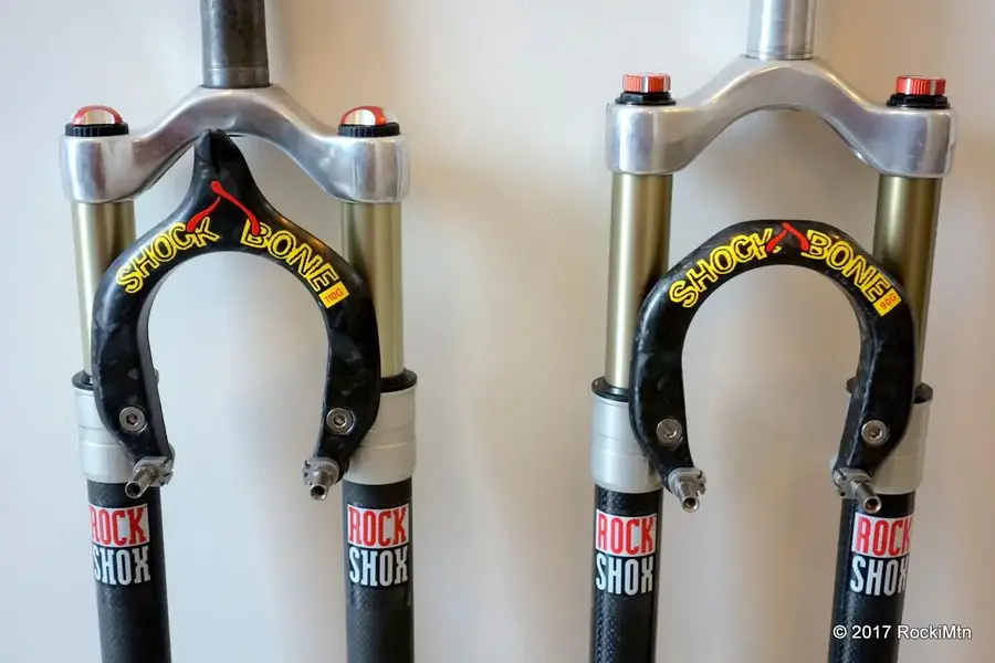

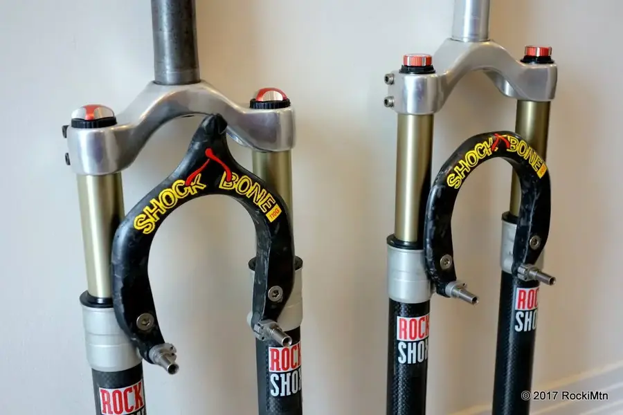

finally all sorted out and now i have a pair of working FSX forks! :D
Left is shorter travel with Styff Shockbone canti brace and threaded steerer. Internals consist of single Risse GEM cartridge and I believe Speed springs.
Right is longer travel with Styff Shockbone V brace and alum steerer. Internals consist of dual red (DH?) Judy cartridges in both legs and NOS Kronos springs.
Both with proper titanium hardware except the crown bolts, which I'll be ordering. Oddly, the left fork lowers has a matte finish, and the right are glossy. Anyone got any info on the difference in finish?

No idea on finish.
The dual red dampers, can you switch on to a black. As I thought the red were compression dampers and not rebound, so an upside down damper.
Then again I've not taken one apart, don't think I've had one.
Look good though :-)
