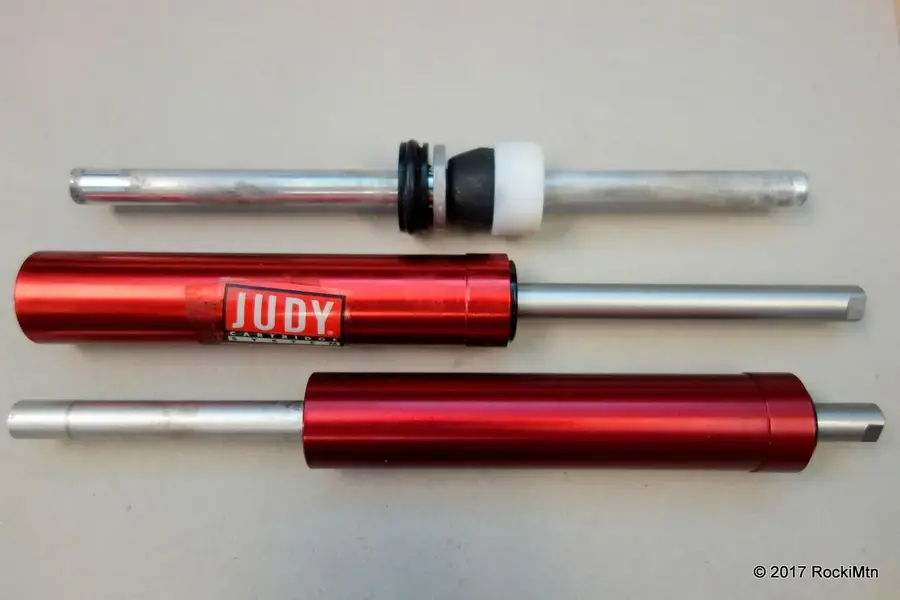

so i picked up two additional Judy forks as spares. one came with a Total Air cartridge, but sadly only in one leg :?, the other had a dummy rod and some worn elastomers. dummy rod measures a little over 210mm in length (as seen at the top).
second fork had no elastomers or springs but had two cartridges still installed. the left leg is the 2nd in the photo and has a Judy sticker on it. the other leg had a similar cartridge (instead of a dummy rod) but slightly darker red anodizing on it without any markings on it. both were about 220mm in length. are these two cartridges the same?
can i assume that the dummy rod is for around 70-75mm of travel and the two red damper cartridges for a fork having 80mm of travel?
is there a reason why i found the two red cartridges in the one fork? is there any advantages/disadvantages for doing so?
Iirc there were "downhill" versions with two dampeners. But I haven't seen one yet. Ot maybe its diy...
