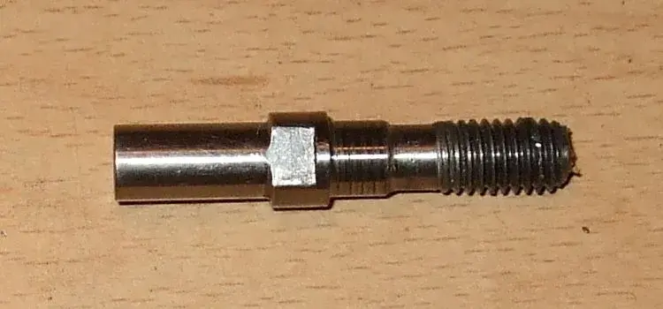

It's quite an unusual bolt, and it doesn't look as though a normal one would do the job at all. It's going through the brace, which isn't threaded, and screwing into the main body of the lowers. The threaded part is 14mm and the total insertion is 25mm.

Forceps":iwdzkxq5 said:
I totally see what you meant but I wasn't clear in the first post. The bosses screw in fine but the problem is the bolt to hold the canti onto the boss. Sorry it honestly made sense when I read it the first time!
Ah so the Canti bolt itself, not the boss.
Just get a shorter one, they are a standard bolt size.
My M770 V-brake bolts do not fit in the fork bosses as they are too long, just use shorter ones.
I wouldn't even cut them down unless they are something special, just get some others.
